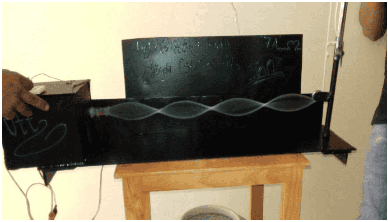

Kundt's tube and standing waves on a string. For example in this picture:
The wave is only driven from the left, but it looks like all anti-nodes have perfectly the same amplitude. Why? Is damping along the string just too low such that no effects are noticeable?
Let's assume a very simple model where the amplitude of the wave is damped exponentially with distance from the generator, and there is no loss at the boundary. Let the generator be at ##x=0## and reflection happen at ##x=\lambda##, and assume anti-nodes at both ends. Then the wave travelling to the right is given by

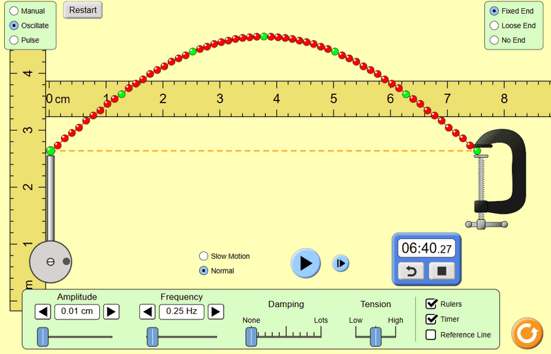

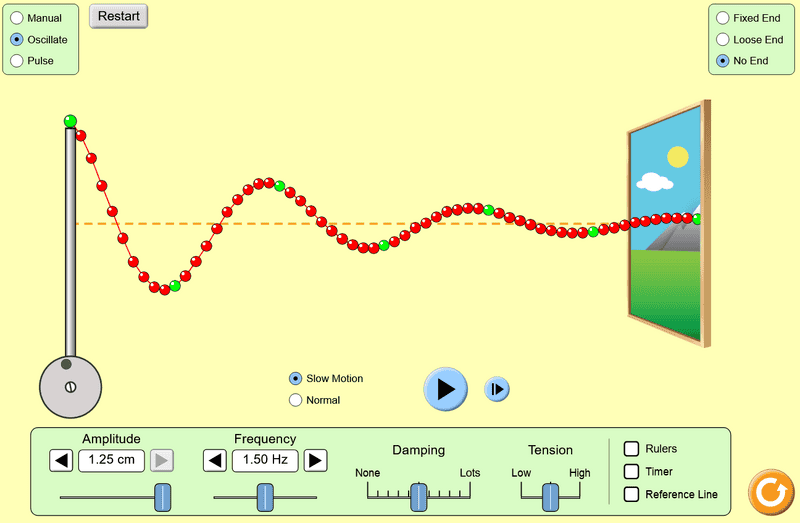

I played around with the following applet:
https://phet.colorado.edu/sims/html/wave-on-a-string/latest/wave-on-a-string_all.html
However, they unfortunately do not say how they model the damping, but it looks exponential to me:

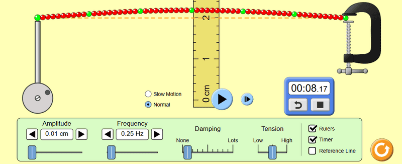

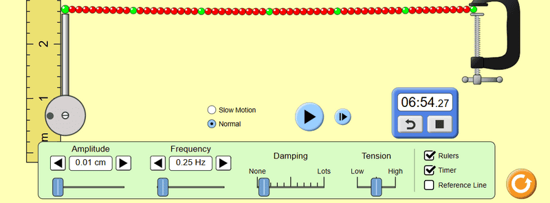

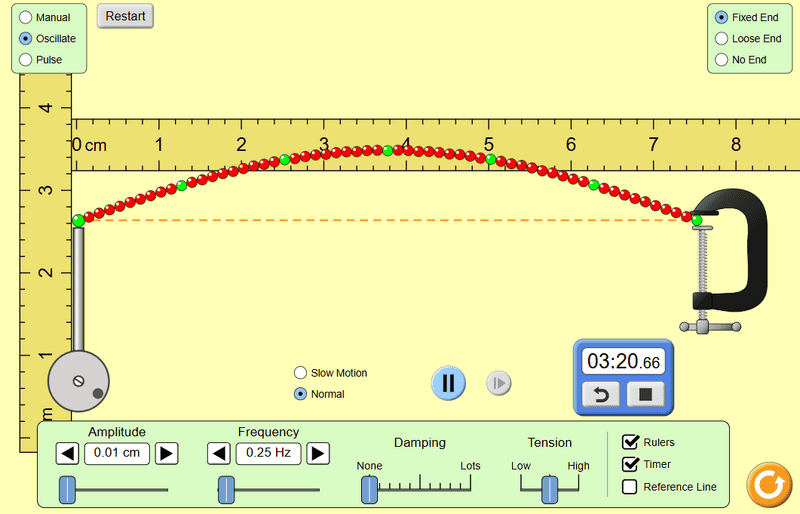

The applet also allows placing a fixed or loose end on the right, but it's quite hard to find the frequencies for standing waves, and there is not enough information provided to calculate them...
Yes, it does take some patience. I wasted time playing with it (instead of thinking :wink:) and approached a resonance with 0.25 Hz (medium tension, no damping)
Takes quite some time to build up
but after 400 seconds the amplitude is about 2 cm. Unfortunately, the smallest increment in damping saps all energy in something like four periods. In two periods the amplitude drops from 2 cm to 2 mm, so ##\kappa## is huge and ##Q## is abysmal:
meaning you can't get a decent resonance. You need to increase the driving amplitude (e.g. to 2 mm), and thus also go to a lower frequency (0.23 Hz), but the amplitude of the wave doesn't go above 4 mm.
Which anti-nodes do you expect to have higher amplitudes, and why?
The vibrating system is an energy store, so that when we first switch on, the generator is mostly occupied in filling the store. When equilibrium is reached, the energy of the generator now supplies only the losses in the system, such as movement of the fixings and sound radiation. During this state of continuous oscillation, there is a large, perfect standing wave and a small travelling wave. The former is the energy store and the latter conveys energy from the generator to the various loads (or sources of dissipation). When the generator is switched off, the energy store then supplies the losses and slowly dies away.
Notice that the standing wave is not altered by the losses in the system, whereas the travelling wave carries only the energy being supplied to the losses. We can find that the phase of the standing wave is everywhere the same except for a sudden 180 degree reversal at nodes. On the other hand, the phase of the travelling wave progresses uniformly along the line. Additionally, if we observe, say, the pressure along a sound pipe, then if it has losses we see that the node is not quite zero, and we see the travelling wave alone at that point, so we actually observe a small component of pressure at that point and find that it is at +/-90 degrees, or in quadrature, to the standing wave.
