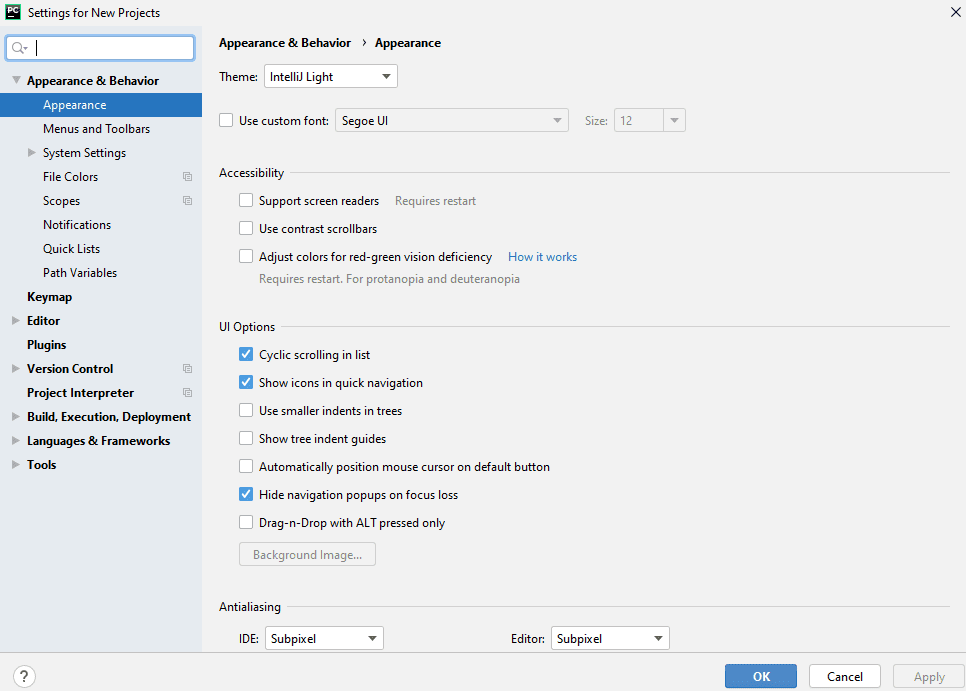

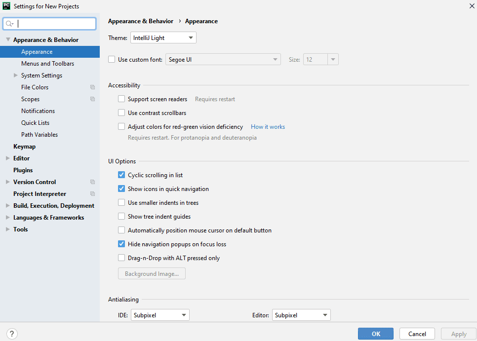

Ack, I downloaded it, but that is the single most unfriendly IDE startup I've run into. Too much of a Darth Vader look for me. How can I change to a Princes Leia look?
  • Haha
Ah, found it under Settings. Turns out the default Appearance is "Dracula". Lordy.
ahh that would be Darkula. Yeah these IDE tools can be daunting at first but they definitely grow on you if you persevere for a few more days. Use google to find a good intro Video on YouTube.
most programmers prefer the dark theme either because we are in the dark about what to do or we’re in that dark stage of a project where we Just want to escape to Hawaii.
