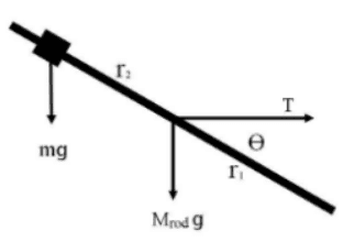

Mrod = 0.025, m = 0.075, r1 =0.165m r2 =0.35m, T = 1.21N Angle = 40 degree
What is the formula to find horizontal and vertical components of the force exerted by the pivot on the rod?
1) Equilibrium condition to calculate the horizontal and vertical components of the force exerted by the pivot on the rod.
2) Pivot exerts a force on the rod, why was this not included in the calculation of the torques?

Homework Statement:: Mrod = 0.025, m = 0.075, r1 =0.165m r2 =0.35m, T = 1.21N Angle = 40 degree
We now know where the pivot is meant to be but:
- what are the units for Mrod and m? lbs, kg, grams, metric tons, other?
- is T meant to act horizontally?
- Is r2 the distance between m and the rod's centre, or the distance between m and the pivot?

- what are the units for Mrod and m? kg
T is a string tension
Distance from pivot to center hole (r1)
Distance from pivot to brass mass (r2)

Mrod = 0.025kg, m = 0.075kg, r1 =0.165m r2 =0.35m, T (String Tension) = 1.21N, Angle Theta = 40 degree.
θ is the angle between the rod and T. Although the diagram makes it look like T is horizontal, this will only be true if the angle between the rod and the horizontal is also θ (=40º). This is not specified.
Let α be the angle between the rod and horizontal. We can calculate α by taking moments about the pivot using the given data.
When I calculate α I get α = 64.5º. Not 40º.
So T is not horizontal. But maybe someone else would like to check.
EDIT: Changed in the light of the extra information in Post #19.
I got α = 64.5º for the angle between the rod and the horizontal under the assumption that the tension is horizontal and has magnitude 1.21 N.
The problem with that is ##\alpha= 64.5^o## and ##\theta = 40^o## are not consistent with T being horizontal.
The clockwise moment produced by the tension is ##T r_1 \sin(40^o)## but this doesn’t rely on T being horizontal.
The 40° angle is ignored in my calculation. I thought that's what you did when you got the 64.5°. We don't have a precise statement of the problem including this (presumably measured) 40° angle. All we have is
bbsgirl10 said:
Theta refers to the angle measured by the sensor minus 90 degree which is 40 degree.
If it is the angle between the tension vector and the rod as shown in the drawing, then the angle between between the rod and the horizontal (by my calculation) is 72.2°. I don't feel confident that I understand what's what with this problem.
Yes, the problem is very badly posed. We can:
- assume that T is horizontal and not use θ=40° or
- assume that θ=40º and treat T as non-horizontal.
Unless the OP can explain, the problem won't get resolved.
