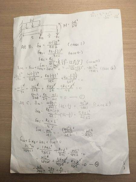

Am I correct? Or should the assumed deflection at B be the difference in deflection between B and C? Thanks

It looks like you are solving this as the superposition of three separate loadings, but you don't provide enough information (text) about the separate solutions to the three loading problems. Please provide more detailed discussion, rather than just a reference to some table.
Sorry that i forgot to embed the reference here. The two photos are the reference i used.

What you need to do is express the displacements at B and C in the following form:
$$\delta_B=C_1W+C_2R_B+C_3R_C$$ and $$\delta_C=C_4W+C_5R_B+C_6R_C$$where the subscripted C's are obtained from the solutions to the separate problems in terms of the property- and geometric parameters. You then set ##\delta_B## and ##\delta_C## equal to zero and solve the results pair of linear algebraic equations for the two unknowns, ##R_B## and ##R_C##.

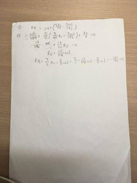

Handwritten working on lined paper for a statically indeterminate beam: a uniformly loaded beam with reaction R_B and R_C, deflection equations for cases 1, 4, 6 and 2, and compatibility equations leading to equations marked (1) and (2).
Handwritten working on lined paper: equation 1 gives RB = 24 × (5Rc/48 − 5wL/192); equation 2 shows −wL/384 + 5/2(5/48 Rc − 5wL/192) + Rc/3 = 0, then −13/192 wL + 19/32 Rc = 0, Rc = 12/114 wL, and RB = 5/2 Rc − 5/8 wL = 5/2 · 13/114 wL − 5/8 wL = −133/192 wL.
Am i correct to calculate like this? Thanks

sorry for unable to type all my formulae out.
I have got "δ=δW+δRB+δRC+δM" for B and C, for which each are using the formula from reference list.
thank you very much
I get the following: $$\frac{R_B}{24}+5\frac{R_C}{48}=\frac{WL}{128}$$ and
$$5\frac{R_B}{48}+\frac{R_C}{3}=7\frac{WL}{(16)(24)}$$
This simplifies to:
$$R_B+\frac{5}{2}R_C=\frac{3}{16}WL$$and$$\frac{5}{2}R_B+8R_C=\frac{7}{16}WL$$
So, $$R_B=\frac{13}{56}WL$$
and $$R_C=-\frac{WL}{56}$$
