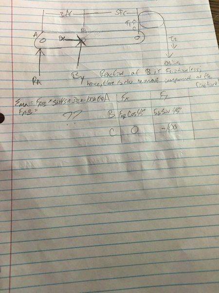

Ive been trying to work out these problems for 2 days now. I've read through the book "Statics and Strength of Materials, Second Edition" By: Cheng. I've googled Everything. I've been on other Forums and have got no reply. I've tried Facebook Math Pages. No Answers. I've been Looking for free help everywhere and I can't Find ANYTHING. I've even asked my instructor for help and he only gives me small hints on where to start.
These make no sense to me and I have no clue where to begin and how to go about solving any of these. This is my last resort. I am going to fail if none of you can help me out. I would love for someone to send pics of working it out if its possible. I've got some of my shown work Written down but I'm 100% Sure I'm going the exact opposite way of where I'm supposed to be headed.

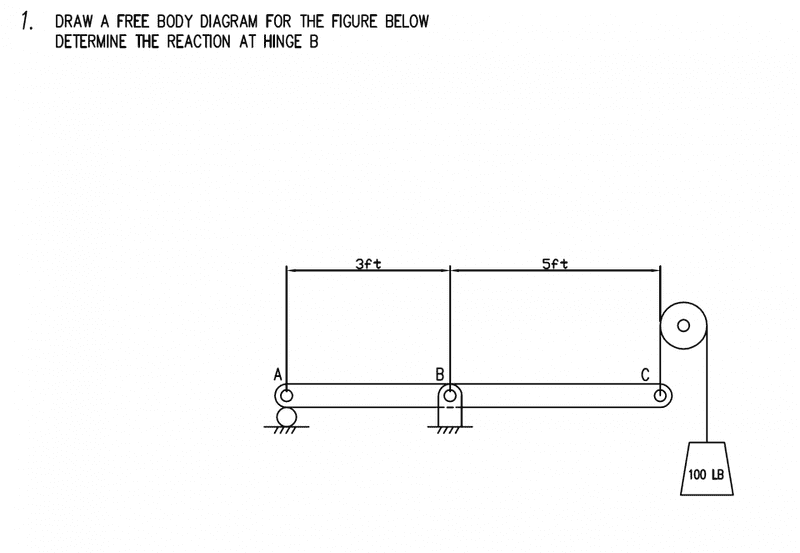

For question 1), BX is zero, by inspection. To find BY, take moments about A. No trigonometry is required.

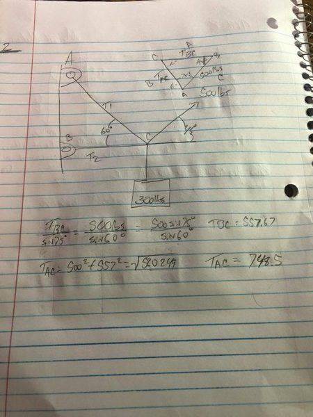

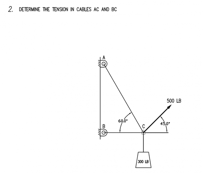

For question 2) It looks like you've completely ignored the hanging mass and the fact that Tac has an X component.
apply the equations of static equilibrium:
∑Fx = 0
∑Fy = 0

Alright thanks ill start there. And I know I'm not supposed to just post pics but i can't explain the problem or what's going on if I don't know how to start or what to do. I can't believe how hard it has been to get just a LITTLE bit of help from the whole internet. Its been exhausting trying to find an active forum or anyone to talk to about it.
