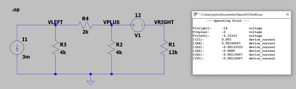

  • One participant reports a discrepancy between their calculated voltage drop of 4V and a simulation result of 2V, seeking help to identify their mistake.

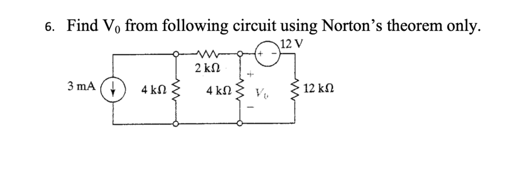

Find V0 from the following circuit using Norton’s theorem only.
Norton's Theorem allowed only

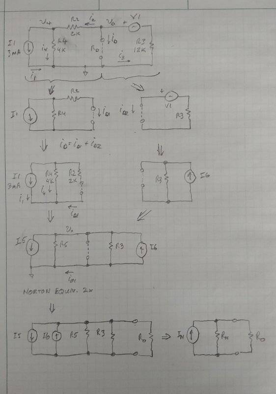

So I've just learned Norton's Theorem and I have this problem on my homework assignment that is wrong. I've checked the answer with a circuit simulator(PSPICE) and the simulation said that V0 should be a drop of 2V. However, my simplified circuit shows a voltage drop of 4V. I have been staring at this problem for an hour trying to find my mistake and I've had no luck. I would be really appreciative if someone could point out where I went wrong.

It's hard to comment on where your mistake is, except that it's at the beginning. I can't follow your reasoning. Why "∴ IN=2mA"?

That's the description I've been pouring over! But I haven't really had any help from it because the examples they use are so simple! I haven't been able to apply it to the less clear-cut questions.
I just figured that the 12V source with the 12kohm resistor would be 1mA, and it would subtract from the 3mA. Sorry, I should've made that clear. To be honest, I have difficulty figuring out how the electricity travels from its source. Like in this example depending on the path it takes I feel like the sources could either add or subtract. I know this is a flawed understanding, but I would appreciate it if you could tell me why it's flawed.
That being said, I considered the possibility that the currents could add. But if IN was equal to 4mA it would lead to my end voltage source being 16V, which would result in an 8V differential for V0, even further from the answer the simulation gave me!
By the way, thank you for responding! I've been really flustered with this question and the subject in general and I was very worried I would get no responses. I really appreciate you taking the time out of your day to help me! :)

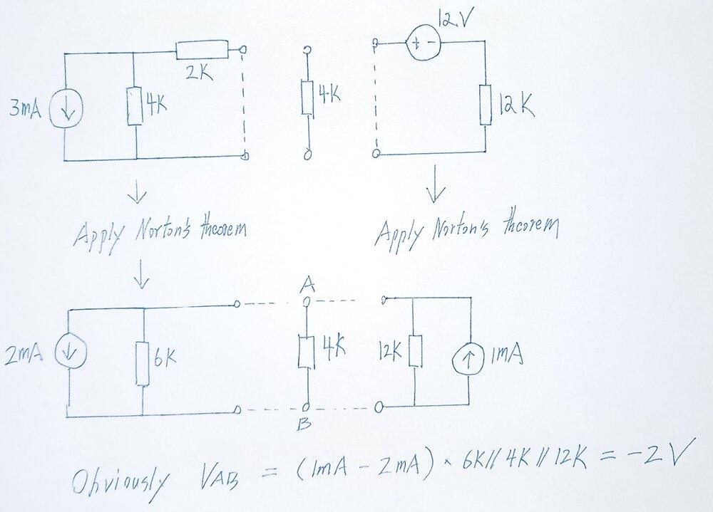

This problem requires that we only use Norton's theorem to solve it, so it seems that we can't even use KVL and KCL, but it does not limit the number of times we use Norton's theorem. :smile:
It's an odd requirement though, pedantically speaking. You are left solving a current divider on the left side, which I claim is impossible to do without Kirchhoff laws or Thevenin's (source transformation). Even two series resistors is simplified with KVL. Granted, it is the simplest possible example of those laws, but still...

I think you should follow up with @Joshy 's advice to split the problem into two parts, left side and right side. Because you have replaced Ro with a short circuit, you can just add those two currents together (the current from the left and from the right). There is no voltage generated in the short circuit branch. so there is no interaction, i.e. a change in the current from one side has no effect on the circuit on the other side.
The next step is to solved the Norton equivalent for the left side. You've already done the right side correctly. Then you can combine the two and rearrange to end up with one current source and one parallel resistor for the final configuration. This is much clearer if you redraw the circuit for each step of the manipulation. as I've sketched out below.

Since this isn't solving the problem I wanted to clarify that the voltage above that resistor is ##-2V##.

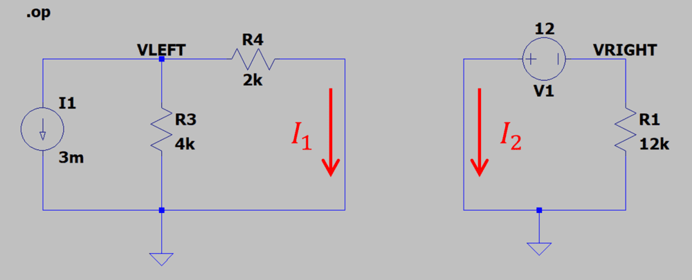

For the circuit on the left, we need to use Kirchhoff's law or Thevenin's theorem to determine the short-circuit current to construct the Norton equivalent circuit.
May you please solve these two circuits and get the current ##I_1## and ##I_2##? Showing your work is a good idea :)

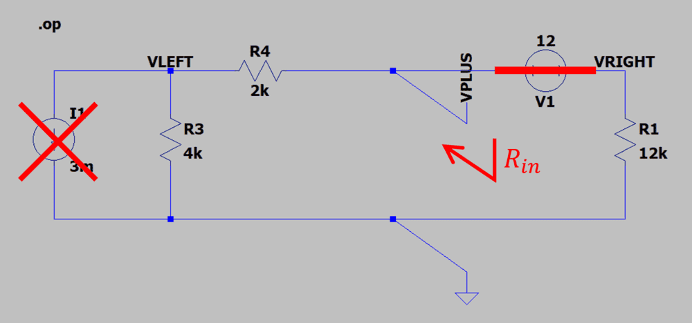

Then solve for ##R_{IN}##

Ah, I finally see my mistake! Since the 3mA source was in parallel with the 4kΩ resistor it can be thought of as a 12V source. However, when you bring in the 2kΩ resistor, the 12V voltage will mean a 2mA current (12/6 instead of 12/4). When I use a 2mA current source in my work, it leads to a final source of 1mA instead of 2mA which halves my answer leading to the correct answer. Thank you so much, everyone! It kinda warms my heart so many people would spend this much time helping me out at no gain to themselves <3
EDIT: Maybe I'm wrong but I believe you made a small mistake at the end? From what I have and from what everyone has shown me, I believe at the end it should just be 6kΩ || 12kΩ without the 4kΩ resistor as that's the load resistor. I did the math and having all 3 in parallel lead me to a resistance of ~13kΩ, which would not equal 2V when multiplied by -1mA. However, if you create the Norton's circuit with the 4kΩ resistor(from 6kΩ || 12kΩ) in combination with the 4kΩ load resistor, they will be in series once the current is transformed to a voltage source(leading to a total resistance of 8kΩ, not 13kΩ). I'm sorry if my explanation was confusing, I'm putting my work underneath:
