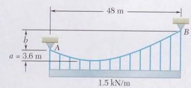

PROBLEM
Cable AB supports a load distributed uniformly along the horizontal as shown. The lowest portion of the cable is located at a distance a = 3.6m below support A, and support B is located a distance b = na above A.
-> Determine the maximum tension in the cable as a function of n.
The equation of the parabola the cable creates when an xy axes is placed at the lowest point of the cable, is
y = w(x^2) / 2*To
Key idea: the maximum tension is located at the support where the slope is maximum.
I think I have to find the length xa first, then use the formula ya= w(xa)^2/ 2*To to get the formula for the tension. The problem is, I don't know how I could get xa.
Please help. Thanks

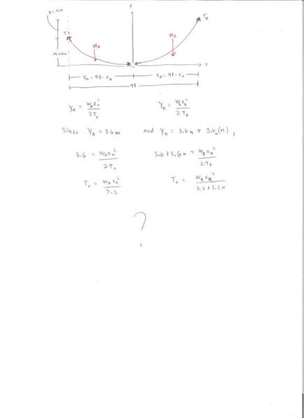

That's what I did. I cut the cable where the lowest point is located, took the moment about a, and got
ya = waxa2 / 2To for the left side and
yb = wbxb2 / 2To for the right side
and when I took the moment about A for the entire body, I obtained another equation.

keximaze: You are doing well, so far. Your first two equations, at the beginning of post 8, are correct. As you know, ya = a, yb = a + b = a + n*a = a*(n + 1), and wa = wb = w.
Your third equation is the very last equation in post 2.
You now have three equations. Solve them simultaneously for the unknowns (as a function of n, which is a known).
