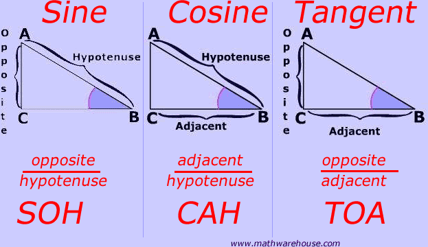

1. Homework Statement
In the picture
In the picture
In the picture My question is .. Why in Fx has sin and Fy has cos ?

In the pictureMy question is .. Why in Fx has sin and Fy has cos ?
Small diagram of a 2D force vector with an angle marked from the horizontal, with a right triangle drawn on it showing the adjacent and opposite sides.
Because of the way the angles are defined and because of how you would find the components of the forces shown. Remember how sine and cosine are defined on a triangle:
