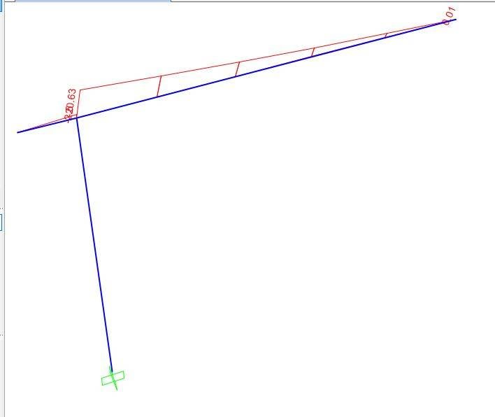

Does the connection between the steel plate and the top beam need to design for moment ?
NA
Hi All, this is a steel frame , top beams sitting on top of column with steel plate cantilever at both sides (one side longer than the other) , so there will be hogging moment at the center support. However, the top steel beam is one whole piece, does the connection between the steel beam and column need to take the moment ? Or the hogging moment will be taken by the steel beam itself ? Connection need not design to take the moment ??
If the connection nned to take moment , then which moment value shall I use to design the connection between the steel plate and the steel beam ?

I think the connection between the plate and the beam above should be designed for the greater moment in the beam (20kNm) , correct me if I am wrong

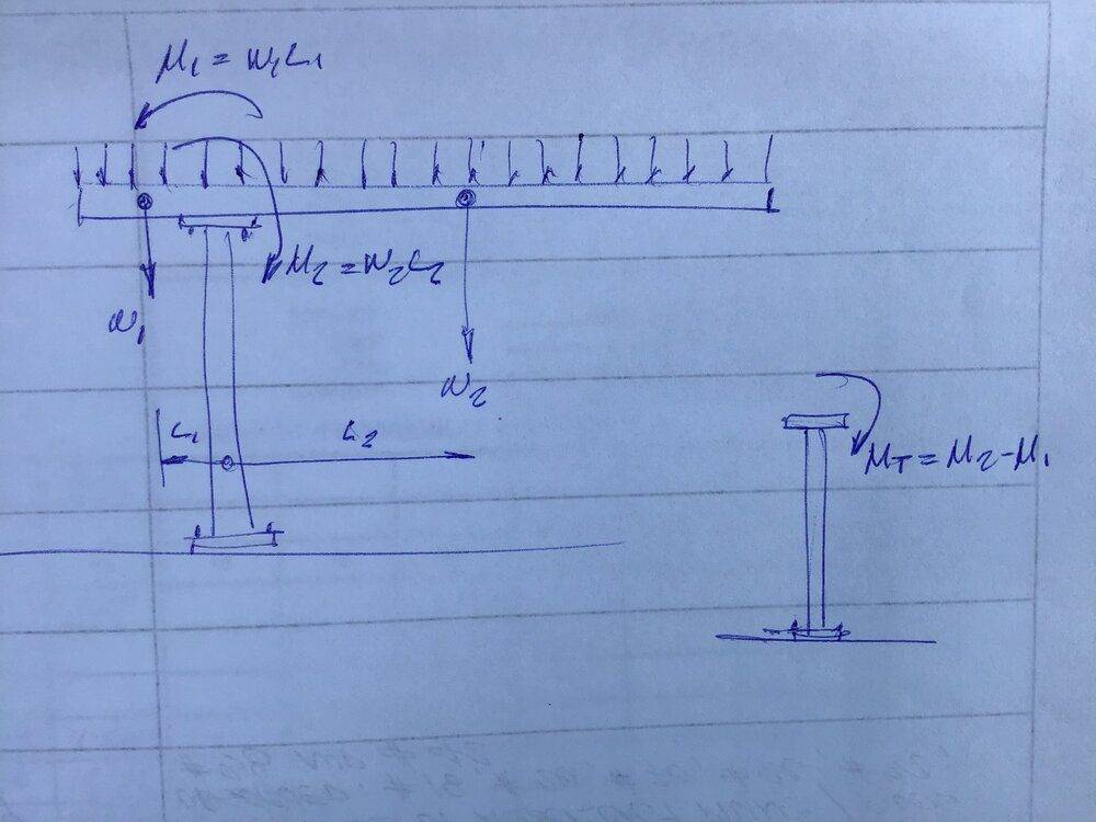

As per your description, both points, connection of beams and column, as well as anchoring of column to ground will have moment stresses to be considered.
Look at the problem this way:
If rather than welded plates at those points, you install pivots, each of which allows free rotation about an axis that is perpendicular to the plane containing beams and column, will the structure be stable?

In this case, the beam is 2 different pieces, welded to the side of column ? If this is the case, I think the connection of beam to the column nned to resist moment .
In my case , the beam is whole piece resting on the column. I am just unsure whether the connection of beam to the plate joining the beam and column together need to resist moment or not . This is confusing.
dccd said:
Thanks for the reply. FYI, the beam on top is whole piece resting on top of column with plate connecting them together... At the center part, there will be large compression acting on it. I know the connection of plate to the column need to resist the moment, but does the connection of beam to the plate nned to resist moment ?
Yes, the welds of column to its plate need to resist moment.
The bolts connecting plate and beam need to resist moment.

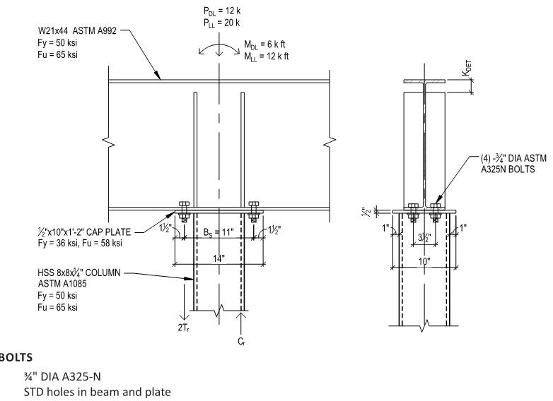

Thanks for the clear diagram. Do you mean the welding of column to the plate need to resist moment of 18kNm , while the bolt between the beam flange and plate need to design for 20kNm moment ??

I mean the column is connected to the plate thru welding, so welding need to take 18kNm of moment, while the connection between the beam above and the plate need to take the 20kNm of moment. Correct me if I am wrong .

If the column were relocated to the midpoint of the beam,
how those values would change and which one would you then choose?
Could we consider your horizontal beam to be two different cantiliver beams under uniform distributed load that share a single fixed point?

At the fixed point where both cantiliver beams meet, you have two moments with different directions.
The distributed load of the left beam counter-balances some of the distributed load of the right beam.
If the column were located midpoint, both moments will have same value and different directions, transferring no moment to the column.

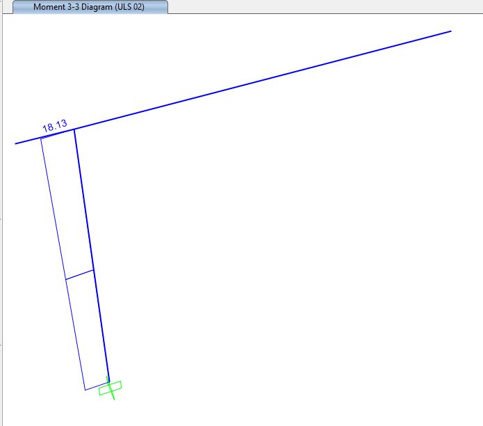

The software has done the calculation for you.
You can see that the moment of the column is uniformly distributed from top to bottom of the column.
That means that the software is seeing the column as a cantiliver beam, fixed at the bottom and having a clockwise punctual moment applied at top.
That value is the minimum moment that the connecting plate and bolts, the entire column, as well as the plate at the base (if any), have to resist, unless additional or accidental loads are applied onto the beam or column.

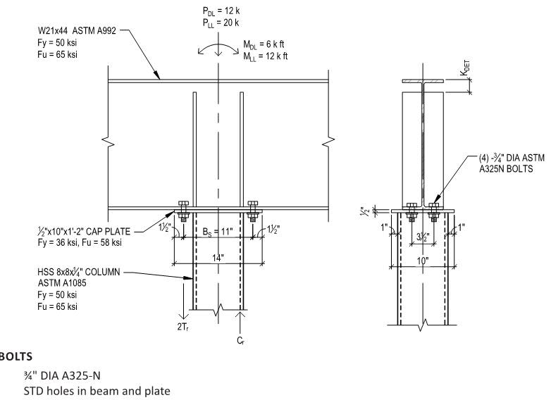

To avoid confusion, let's summarise it into 3 parts,
1st part , the base,
2nd part the connection between the column and the plate and,
3rd part , the connection between the beam and the plate.
For 1st part, i know the connection has to design for moment of 18kNm.
For 2nd part, the connection has to design to withstand the moment of 18kNm.
For 3rd part, I think the connection need to design for the moment of 20kNm, because the member itself can withstand 20kNm, the connection must also be able to take 20kNm, otherwise, hogging will happen..
Correct me if I am wrong.
