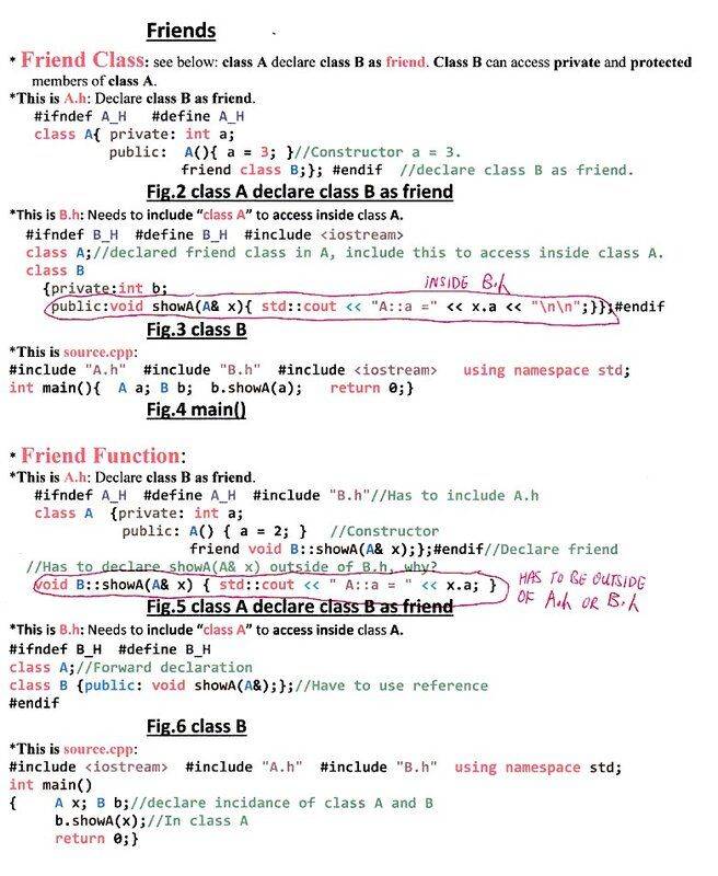

I spent some times on the first link and I actually typed two of them in. I still have a question. Regarding the friend function, it is different if I declare a class as friend or just that particular function as friend. I put this in my notes. You can see Fig.2 to Fig.4 are declaring class A as friend, Fig.5 to Fig.6(forgot to label the last one) only declare function showA() as friend. For function showA() as friend, I cannot have the function body inside any of the header file(see Fig.5). Where as for declaring class A as friend, I can put the body of the function inside class B.in Fig.3.
What is the difference and why? Or it's just is and just remember it? I circled the two lines in question in RED.
Thanks
Why are you using friend? It is used rarely, and when it is used, it is usually misused. It's a red flag, because it is often used as a band-aid over bad class design, breaking encapsulation rather than fixing the problem.
If it's to allow you to keep your fileClass and vector Class design, you are much better off reworking them as one class as @pbuk suggested.
While it may be a RED flag for programmers, its described in his book and so the OP is trying to understand how it is used.
I just looked at what's in the book. It does not give a very clear use case: it would be better to create a public method. Or maybe refactor the classes entirely.
I see friend having two primary use cases. One is the Memento design pattern, which allows one to roll an object back to a previous state. The other is an object used only for testing and debugging. There might be some other use cases, but "I want to use a member object directly from another class rather than write an accessor or mutator" is probably not one of them.
