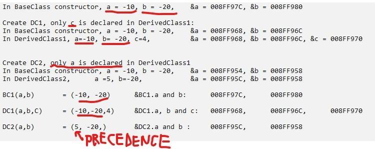

1) I want to verify when saying the object of derived class inheriting member variables and member functions, this means the object of derived class has it's OWN member variables a, b and c. Has it's OWN member function BaseFunc21(), BaseFunc12() and DerivedFunc11().
2) The second question is more confusing to me as shown with BaseClass2 and DerivedClass2:
Line 33 shows DerivedClass2(int b, int c) : BaseClass2(a, b) { }. Notice variable b is common name defined in DerivedClass2 and in BaseClass2. How many b do I have in the object of derived class? b belongs to DerivedClass2 or BaseClass2?
For default constructor, it's easy to understand. Line 13 DerivedClass1() : BaseClass1(){ c = 0;} just simply combine both constructors to give a=0, b=0 and c=0. But for constructor with arguments and variable with the same name, it get's confusing. which one should I choose.

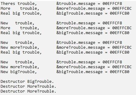

While I am waiting for you guys to comfirm, I am hot on the trod verifying what I ask in the OP. I think I am correct on the first part that the derived class object has it's COMPLETE set of member variables of it's own.
From stepping through each object of the derived classes and the base class have different memory address for c-string str as shown. I even change the content of the c-string step by step to proof the other two keep the original content.
This is my program that I have a base class Trouble, then a derived class MoreTrouble. Then a derived class BigTrouble derived from MoreTrouble. I stepped and put the addresses of both c-string str and message in the comment of the line of code. You can see they are all different from each other.

this is the printout from running the program:
I even change the name str to str0 for Trouble class, str1 for MoreTrouble class and str2 for BigTrouble class. The result is the same running the program. So I still don't know what to make of str in the constructor of the derived class.
The program is working.

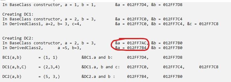

Your DerivedClass2() constructor is pretty silly. BaseClass2 has two member variables, a and b. DerivedClass2 has no variables of its own, but it has access to the a and b variables that belong to the base class. The fact that you have parameters named b and c for one of the DerivedClass2 constructors doesn't mean anything at all. You could have named them x and y and it would make no difference. You could have done something more interesting if DerivedClass2 had its own variable named a.
Here's an example that's based on yours, but with a lot of cruft removed. Since you didn't do anything with the various member functions, I have omitted them.
Use the debugger to investigate the member variables a and b of BaseClass, and the member variable of DerivedClass2.
You have made it more confusing with the different constructor parameter names. Focus on the example I gave above, and maybe it will answer your questions.

I have the second program in post 2 to verify all 6 c-strings in the 3 objects (trouble, morTrouble, bigTrouble) from different classes with the same name str and message have different addresses in the memory.

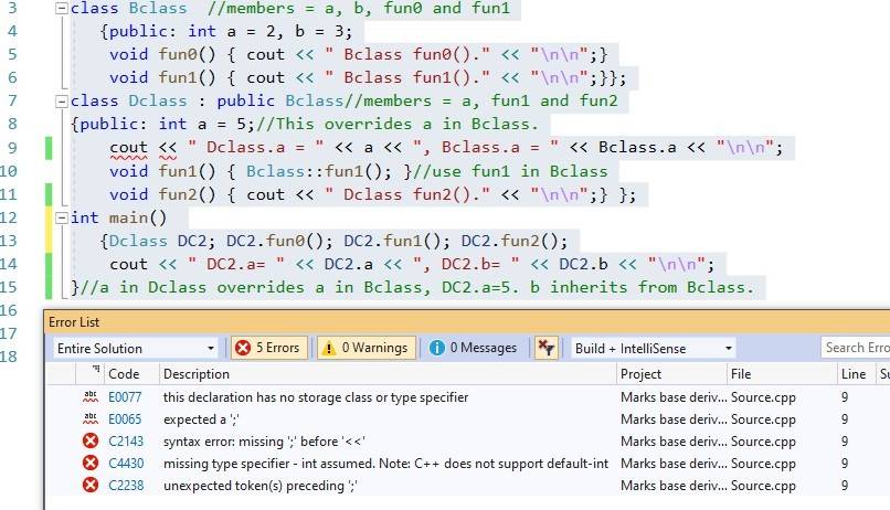

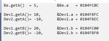

Hi Mark, I am going to work on your sample program tomorrow, I am still on the first part of my question so far.
I whipped up a very simple program to proof my point that the OBJECT of the derived class contains of all the members of both the Base class and Derived class.

    count << " Dev2.getA()= " << Dev2.getA() << ",\t&Dev2.a = " << &Dev2.a << "\n\n";
    count << " Dev1.getB()= " << Dev1.getB() << ",\t&Dev1.b = " << &Dev1.b << "\n";
    count << " Dev2.getB()= " << Dev2.getB() << ",\t&Dev2.b = " << &Dev2.b << "\n\n";
The output of program is shown below:
I have one Object Be of the Base class, I have two Objects Dev1 and Dev2 of the Derived class. I set the values of a and b for Objects Be, Dev1 and Dev2. The program read the values of a and b for all three objects together with the ADDRESS of a and b of EACH Object. You can see all the addresses are unique. this show each Object of the derived class has all the members from the Derived class AND Base class.

OK, I read through the program, added lines to display values and address of a, b and c inside the BaseClass, and the two DerivedClass. Also Display the values and address for BC1, DC1 and DC2.
In my program, look at every line, I have the stepping to the next line in comment at the end of each line like: //go to line #. So you can step through the program just by following the numbers, don't have to step in Debug.
C++:
#include<iostream>
using namespace std;
class BaseClass
{public:    int a, b;
    BaseClass(int A = 0, int B = 0)                                 // 6
    { a = A; b = B;                                                 // 7
      count<<" In BaseClass constructor, a = "<<a<<", b = "
       <<b<< ",\t&a = " << &a <<", &b = " << &b << "\n";            // 9
    }                                                       //29, 14, 22
class DerivedClass1 : public BaseClass
{public:    int c;
    DerivedClass1(int A = 0,int B = 0,int C = 0):BaseClass(A,B)     // 5
    {   c = C;                                                  //13, 15
        count << " In DerivedClass1, a=" << a << ", b= "<<b<<", c="  //
      <<c<<",\t\t&a = "<<&a<<", &b = "<<&b <<", &c = "<<&c<<"\n\n"; //17
    }                                                               //31
class DerivedClass2 : public BaseClass
{public:    int a;
    DerivedClass2(int A = 0, int B = 0) : BaseClass(A, B)           // 5
    {   a = 5;                                                  //21, 23
        count << " In DerivedClass2,\ta =" << a << ", b="<<b<<
          ",\t\t&a = " << &a << ", &b = " << &b << "\n\n";          //25
    }                                                               //33
int main()
{   BaseClass BC1(1, 1);                                            //5
    count << "\n Creating DC1:\n";                                   //30
    DerivedClass1 DC1(2, 3, 4);                                     //14
    count << "\n Creating DC2:\n";                                   //32
    DerivedClass2 DC2(2, 3);                                        //22
    count<<" BC1(a,b) \t= ("<<BC1.a<<", "<<BC1.b<<
    ")\t  &BC1.a and b:\t     "<<&BC1.a<<",      "<<&BC1.b<<"\n\n"; //36
    count<<" DC1(a,b,C)\t= ("<<DC1.a<<","<<DC1.b<<","<<DC1.c<<
        ")\t  &DC1.a, b and c:   "<<&DC1.a<<",\t    "<<&DC1.b<<
        ",\t   "<< &DC1.c<<"\n\n";                                  //40
    count<<" DC2(a,b)\t= ("<<DC2.a<<", "<<DC2.b<<","<<
     ")\t  &DC2.a and b :     "<<&DC2.a<<",\t    "<<&DC2.b<<"\n\n"; //42
This is the screen capture of the output of the program in cmd:
This is my observation and reasoning:
For DerivedClass1, a and b are NOT defined in DerivedClass1, so it just take the a and b from the BaseClass. c is defined in DerivedClass1, no issue there.
In DerivedClass2, only a is defined, Pay attention to DC2, the address and the value of a in BaseClass constructor and DerivedClass2 is different both the value and address. Seems like when a is redefined in DerivedClass2 , it takes precedence over the variable a in the BaseClass. Is this correct?
Seems like Both DC1 and DC2 objects contain ALL the variables defined in Base and Derived classes like I said, just the matter of who takes precedence when BOTH declare variables of SAME name.
What am I missing?

OK, I want to proof my point that if both Baseclass and DerivedClass declare a variable of the SAME NAME, the one in DerivedClass takes precedence. I modified the program by forcing a = -10 and b = -20 in line 6 of the BaseClass and here are the results:
C++:
#include<iostream>
class BaseClass
{public:    int a, b;
    { a = -10; b = -20;                                             // 7
    }                                                       //29, 14, 22
{public:    int c;
    {   c = C;                                                  //13, 15
    }                                                               //31
{public:    int a;
    {   a = 5;                                                  //21, 23
    }                                                               //33
int main()
    count <<"\n Create DC1, only c is declared in DerivedClass1:\n"; //30
    count << "\n Create DC2, only a is declared in DerivedClass1\n"; //32
This is the screen shot of the cmd window:
After I played with your program for like 10 hours, I still see the OBJECT of the DerivedClass contain ALL the variables from BOTH the BaseClass and the DerivedClass.
And from this program, If a variable is declared with the SAME in both BaseClass and Derived Class, the one in the DerivedClass takes precedence as shown that in the Object DC2 of DerivedClass2 that the value remains as (5, -20).
a is defined in DerivedClass2, but a is also defined in BaseClass. The data member a in DerivedClass2 is not redefining the one with the same name in BaseClass - it overrides the base class member of the same name. They are both there in the derived class.
Here's a slight refinement of the DerivedClass2 class declaration:
C++:
public:
    int a;
        a = 5;
    void fun()
        count << "Hi from DerivedClass2!" << endl;
        count << "DerivedClass2.a: " << a << endl;
        BaseClass::fun();            // Call fun() in base class
        count << "BaseClass.a: " << BaseClass::a << endl;
When fun() is called, such as from main(), the code above will display the values of both a members. Without being qualified, a evaluates to the DerivedClass2 member. By being qualified, as in BaseClass::a evaluates to the BaseClass member.
If you replace the DerivedClass2 declaration in my earlier example with the code above, you'll see both a members are present.
What am I missing?
Like I said, the a in DerivedClass2 overrides a in BaseClass, but it's possible to access both of them.
Well, yes.
The derived class data member overrides the data member of the same name in the base class. Also, (5, -20) is not a value. It's a pair of numbers, the values of a and b.

I have a strange error I cannot explain. This is really simple, but that's what make it hard!
C++:
#include<iostream>
using std::count;
class Bclass  //members = a, b, fun0 and fun1
   {public: int a = 2, b = 3;
    void fun0() { count << " Bclass fun0()." << "\n\n";}
    void fun1() { count << " Bclass fun1()." << "\n\n";}};
class Dclass : public Bclass//members = a, fun1 and fun2
{public: int a = 5;//This overrides a in Bclass.
    count << " Dclass.a = " << a << ", Bclass.a = " << Bclass.a << "\n\n";
    void fun1() { Bclass::fun1(); }//use fun1 in Bclass
    void fun2() { count << " Dclass fun2()." << "\n\n";} };
int main()
   {Dclass DC2; DC2.fun0(); DC2.fun1(); DC2.fun2();
    count << " DC2.a= " << DC2.a << ", DC2.b= " << DC2.b << "\n\n";
}//a in Dclass overrides a in Bclass, DC2.a=5. b inherits from Bclass.
This is the error:
I have no idea why this won't work. Just a simple count statement!
Strange!
Thanks
C++:
#include<iostream>
using std::count;
int main()
This is the error:
Your attempt to call count is not inside any function definition. This is not allowed. Did you mean to do it inside the Dclass constructor? If so, you have to define a Dclass constructor!
[CODE lang="cpp" highlight="3"]main() {
count << "See why this won't work?" << endl;[/CODE]
But the line is inside the {} of class Dclass {...}
I just don't see it! I must be missing big time here!
thanks
But it's not in a function.
Think about it this way - when do you expect it to run?
