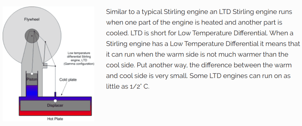

i need a simple calculation of a stirling ltd surface area calculation per watt produced and would a very rough surface and very large surface area hinder heat flow if the distance to re generator is extreme /would folding the surface area of a flat plat ltr help increase the power of engine
most small ltd engines use smooth aluminum to transfer but would crimping the metal and diffuser to match the crimp increase surface area and turbulence near the metal allowing for increased heat transferance

i need a simple plate size calculation.
the power piston size is dependent on the displacer size but if i add additional ripples to increase surface area will it increase the power piston displacement
a given temp for engine is 70 degrees for cool side and 140 for warm side
both will be using water to transport heat and cold
both hot and cold engine sides will be made of aluminum block w fast flow pumping for heat transfer
aluminum block will have as much of a ripple or crease or fold to maximize heat transfer
i just need a simple calc using a plate size ,so that i can see how much more energy can be utilized by simply increasing heat transfer area compared to increasing flat plate size

jeff jones said:
Plate size meaning heated surface area not displacer size
The hot plate heats the displacer through the air gap.
The displacer moves to the cold plate, heating the air it passes, increasing the pressure.
That pressure moves the piston, increases the volume, so lowers the temperature slightly.
The cold plate cools the displacer through the air gap.
The displacer moves to the hot plate, cooling the air it passes, lowering the pressure.
That depression allows the piston to return, reduces the volume, so raises the temperature slightly.
The hot plate stays hot because of contact with the 140°C hot water heat source.
The cold plate stays cold because of contact with the 70°C cooler water heat sink.
The limit to power is the rate of heat flow. It is highly probable that the limiting factor will be the transfer of heat through air from the inside of the end plates to the displacer. The external plate area will be sufficient even if it is flat. The ripples therefore need to increase the area of the displacer to end plate contact, or you need a greater area of displacer.
There is no simple relationship between external exchange area and engine power.
There are four thermal surfaces in series. Heat flow across each surfaces is proportional to temperature difference and area.
Start with the heat source, water at 140°C, and the sink water at 70°C. Assume the internal hot air contact is at 130°C and the internal cold air contact at 80°C. The temperature difference available is then 50°C.
If you double the area of both external water contact surfaces the temperature lost across each interface will fall from 10°C to 5°C. The temperature difference available is then 60°C. Increasing the external water area to 200% does increase available power, but only by 20%.
So the area of the water contact is not a strict limitation to power. With Stirling engines all things are relative, and ratiometric. Adjusting the compression ratio, internal pressure or regenerator capacity can make a bigger difference.
