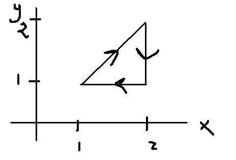

Assume the vector function
[tex]\vec{A} = \hat{a}_x \left( 3x^2 y^3 \right) + \hat{a}_y \left( -x^3 y^2 \right)[/tex]
Evaluate
[tex]\int \left( \nabla \times \vec{A} \right) \cdot d\vec{s}[/tex]
over the triangular area (see figure attached).

[tex]\int \int \left(-12x^2 y^2 \right) \, \hat{a}_z \cdot \left( dx dy\right) \hat{a}_z[/tex]Not sure about the limits of integration - THIS IS "THE" PROBLEM. Maybe it's trivial and I just can't see it right now. I do expect to get one of the limits as a variable.
I actually did the other way around (via Stokes' Theorem) P1 (1,1) to P2 (2,2) to P3 (2,1) to P1 and got
[tex]\oint _S \vec{A} \cdot d\vec{\ell} = 7y^3 - 7x^3[/tex]
I'm pretty sure this one is right, so I keep trying to make my other method work but without success so far. Any help is highly appreciated.

  • Hand-drawn right triangle in the xy-plane with vertices at (1,1), (2,1) and (2,2), with arrows on its sides and axes marked 1 and 2.

Surely, you learned how to handle this long before you got to Stoke's theorem! The region is a triangle with vertices at (1,1), (2,1), and (2,2). If you choose to integrate with respect to y first, so that the outer integral is with respect to x, then x must cover the entire figure: x must go from 1 to 2. Now, for each x, y must go from the lower edge, y= 1 to the upper edge which is the line y= x. Your integral is
[tex]\int_{x=1}^2 \int_{y=1}^x f(x,y)dydx[/tex]
If, instead, you want to integrate with respect to x first so that the outer integral is with respect to y, then, again to cover the entire triangle, y must go from 1 to 2 and, for each y, x must go from the line x= y on the left to the line x= 2 on the right. Your integral is
[tex]\int_{y= 1}^2 \int_{x=y}^2 f(x,y)dxdy[/tex]

HallsofIvy, thanks for your comments.
I actually tried those limits before, which sound reasonable to me - by the way. The problem is that I do get
[tex]\int _1 ^2 \int _y ^2 \left(-12x^2 y^2 \right) dx dy = -\frac{98}{3} \neq \oint _S \vec{A} \cdot d\vec{\ell} = 7y^3 - 7x^3[/tex]
Hence, one of the sides is not correct. I double checked the work on the circulation and I can't see a mistake. Here's what I've got:

You said you could do the path integral around the boundary! You do understand that the path integral should be a number, not a function of x and y?
:rolleyes:
I get 98/3 both ways- integrating over the surface and integrating around the boundary. (NOT -98/3: Since the path is clockwise around the surface, the normal is [itex]-\hat{a}_z[/itex], not [itex]\hat{a}_z[/itex]: "right hand rule".)
I divided the boundary into three parts:
I: The line from (2,1) to (1,1). Take x= t with t going from 2 to 1, y= 1. Then dx= dt, dy= 0 so the integral becomes
[tex]\int_2^1 3t^2 dt= t^3 \right|_2^1= 1- 8= -7[/itex]<br /> <br /> II: The line from (2,2) to (2,1). Take x= 2, y= t with t going from 2 to 1. Then dx= 0, dy= dt so the integral becomes<br /> [tex]-8\int_2^1 t^2 dt= -\frac{8}{3}t^2\right|_2^1= \frac{8}{3}(1- 8)= -\frac{56}{3}[/tex]<br /> <br /> III: The line from (1,1) to (2,2). Take x= t, y= t with t going from 1 to 2. Then dx= dy= dt so the integral becomes<br /> [tex]\int_1^2 (3t^5- t^5)dt= 2\int_1^2 t^5 dt= \frac{1}{3}t^6\right|_1^2= \frac{1}{3} (64- 1)= \frac{63}{3}[/tex]<br /> <br /> So the complete integral is <br /> [tex]- 7+ \frac{56}{3}+ \frac{63}{3}= \frac{-21+ 56+ 63}{3}= \frac{98}{3}[/tex][/tex]
