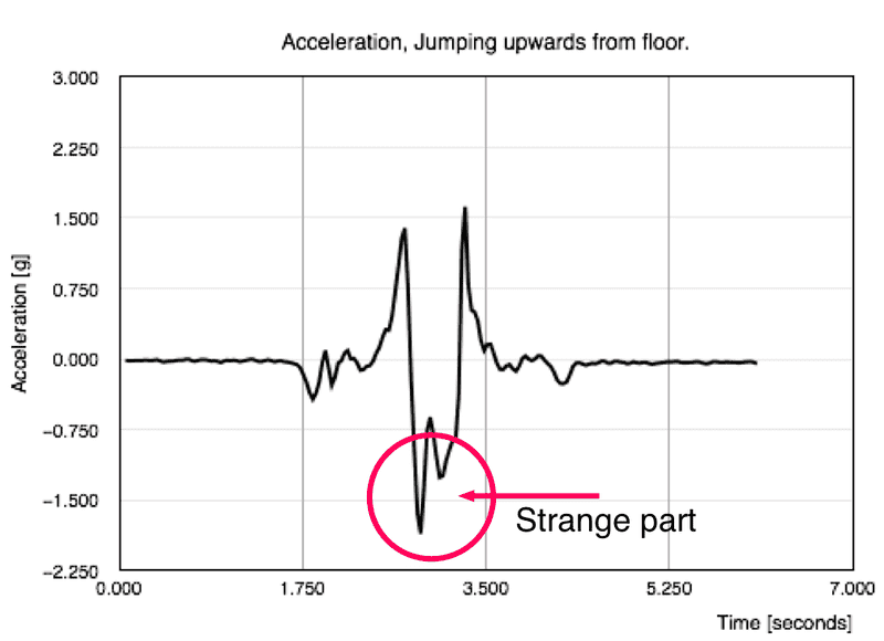

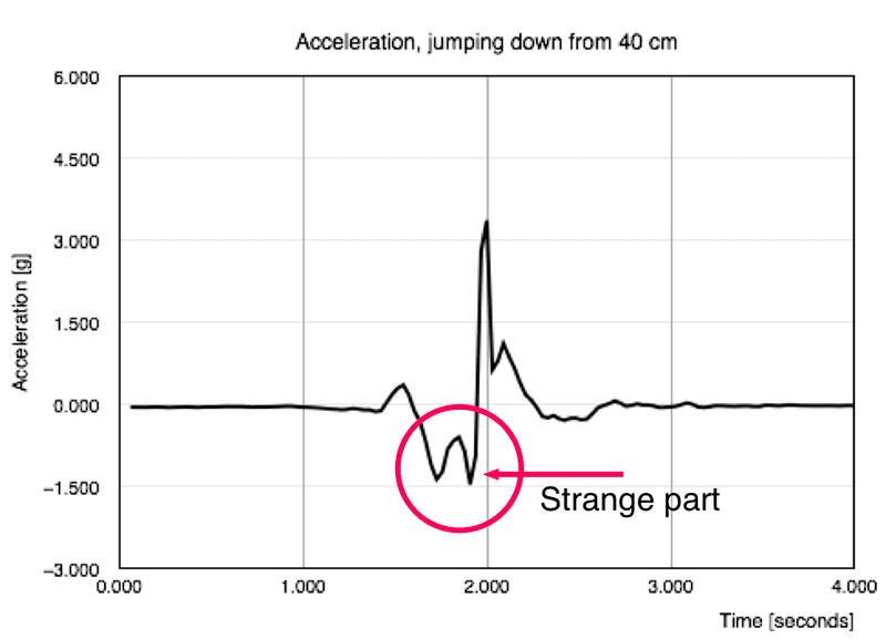

Hi!

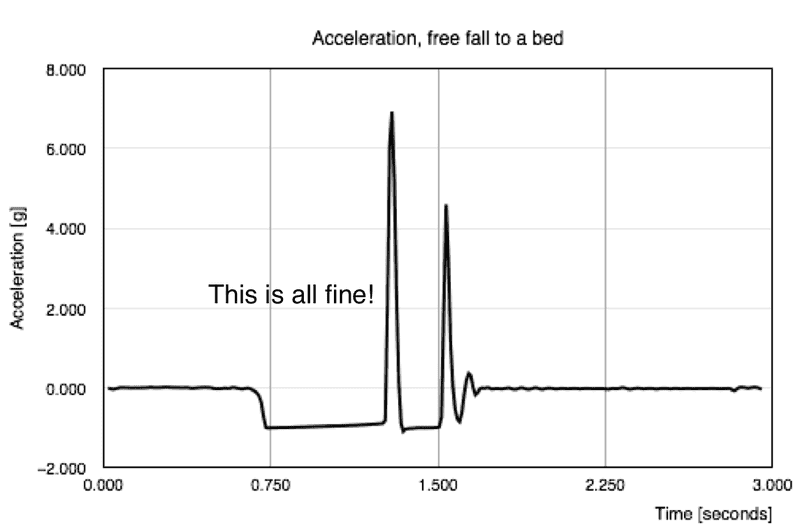

I have just performed some experiments with my phones accelerometer, and plotted the acceleration as a function of time from the raw data. The experiments I did was:
  • jumping down from a chair
  • jumping from the floor and up
  • let the device fall toward a bed
When I analyze the graphs, I think it's strange that the absolute value of the acceleration is more than g during the jumps, but close to g during the free fall (about 1.5g and 2.0g for jump from a 40 cm high chair and straight from the floor, respectively, during the free fall it seems). Can it be something I do during the jump (is technically possible without being stucked to the floor)?
During the jumping, the phone was fixed in the waist belt.
I attach the 3 graphs. Someone here who has an explanation for the marked strange parts in the graphs (it should be values of about -1, I think)?
Sure. The position of your waist relative to your center of mass changes if you change your body shape, e.g. change the position of your legs (something you certainly do in some way during the jump), which leads to an acceleration.
How did you take into account that the phone measures all three acceleration axes? Its orientation might change during the jump.
I don't know smartphone accelerometers well enough, but in general those things need some time for a proper measurement (in the same way a bathroom scale will need some time for the measurement). If acceleration changes suddenly, the values might be off.
Thank you. Maybe the position thing. About the acceleration axes, I just used the z-values (positive upward).
The orientation of the phone can change, which will influence the measurement.
Try adding a line on the first graph at -1g.

@UncertaintyAjay: Accelerometers at center of mass of an object in free fall will measure an acceleration of zero. As they expect to be on the surface of Earth, they subtract g and get -1 g acceleration in the lab frame. That's the baseline here. The thread is about the deviations from this -1 g.

I was doing the same vertical jump experiment and I came across this forum in search for an explanation for the same high acceleration pattern during flight i.e. free fall. It did not really make sense to me, even in an accelerated frame of reference. I played around a little and I came up with this explanation: I think it has mainly to do with the fact that you are usually stretching your body during the jump (hope that makes sense, I am not a native speaker) and what you actually do with your feet. When I tried to keep my feet flat during the jump, I ended up with accelerations closer to g during flight.
