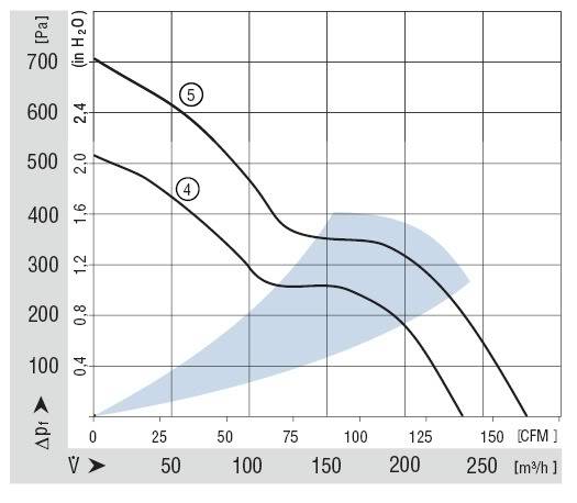

I am looking at fan curves here at work and I stumbled upon this one. Its for an 80mm diameter tube axial fan.
What's up with the Flowrate vs RPM curve (the dashed line)?
In the flowrate interval between 12 - 23 CFM there are instances of the same RPM for different flowrates.
That doesn't make sense to me :confused: For a fixed geometry and a fixed RPM how on Earth can we have different flowrates?
Unless it is accounting for blade deformation?
Any thoughts?
That seems atrange to me as well. It seems to me that generally the flow rate should increase with fan RPM so either something is wrong with the test, or something unexpected is going on with their fan.
The fan is not a constant displacement "pump" like a water or hydraulic pump. With different static pressures, there is different "leakage".

From a physics background this looks like hysteresis, where there is more than one stable solution to your conditions (eg at 3100 RPM you can have two different flow rates), and the certain state that you are presently is dependant on history. I can't think of a physical explanation for it, though.
Maybe at those conditions the blades were in some sort of stall or surge condition.
Ah. I think that could make sense. So I've seen other fan curves that explcitly
show a 'stall region.' This one does not. Is there a way to get that info
from this plot? Or do I need pstag to know that (or even more than that)?

No, the test is done under a varying resistance in order to generate the static pressure vs cfm curve. You use a damper in a duct and as you throttle it back, you measure the cfm, static pressure and rpm.
Yes, what that curve is telling you is that the fan at its nominal 12v can maintain a roughly constant 3,000 rpm, but that changes in the airflow and static pressure will cause various aerodynamic effects such as stalling and surging. Note that the difference in rpm across the operating range is only about +-5%. That's a pretty small variation.
That's the "surging" that minger was referring to. Under some conditions a fan can indeed have two different flow rates at the same rpm. The flow rate will actually jump back and forth between the two and that oscillation will make the duct rumble like there is a freight train running through it and can physically damage a fan.
Interesting. That makes sense. Russ, does this particular test have a name? I would like to look into it some more to get a better understanding of fan curves in general. If I knew the specific name of the test, it would make my researching a little easier. Thanks.
Usually we just refer to these tests as fan mapping tests. I don't know of an "official" name for them. Usually, you will see a "whoopy-doo" in the flow line in the same area as the rpm increase. That is where the stall region is. It doesn't really show in that plot which adds to the confusion. Perhaps they don't have the fidelity in the flow data to pick it up.

Also, I am still confused by the fan curve in post #1. Is it in this 'sloppy' region over the entire fan curve? Why wouldn't they adjust the power input such that the fan runs at a nominal RPM < 3000?

They are, essentially, doing a single speed line from a compressor map. The fan is held at a constant speed (as close as you can) and the outlet of the fan is varied from wide open (highest flow, lowest pressure rise) to fully closed (zero flow and highest pressure rise). The flow and static pressure is measured on the outlet of the fan.
The affinity laws are used in the "if everything else remains constant" scenario. In this case, the outlet conditions of the fan change so the affinity laws don't apply.
Okay. Thanks for that explanation FredGarvin. I just don't understand what other fan curves are doing now. For example, in this curve, how did they do the mapping? Did they hold RPM constant or not? Is it assumed that they did? I just don't see how one would know if they do not publish that detail.
That's why I tried Googling 'fan mapping test' so I could better understand the test. But I did not get any returns on 'fan mapping test.'

That's exactly the same thing. In your second plot, the show 2 different fan speed lines. Both of them show the stall/surge area right around the 75 CFM mark. Each line should be labeled with a speed. Line 4 is a lower speed line than 5.
Have you seen this link?: http://en.wikipedia.org/wiki/Compressor_map
So in general, fan curves represent a 'constant rpm' line? That is the curves were mapped using a fan whose speed was maintained?
Here's a long article on various causes of flow instabilities:
http://www.achrnews.com/Articles/Feature_Article/ac51bcf96e75a010VgnVCM100000f932a8c0____
So when we look at the curve, we are not correct in assuming the data has been taken when the fan was in a steady state? The fan operating at one RPM can have a variety of speeds, and it is just a statistical effect that we see the curve going up and down, as a result of the state of the flow at a certain time of sampling?
This makes the data meaningless to some degree... surely you need a stable flow before you can obtain measurements!
Seems to me to be analogous to plotting the angle of a pendulum against its length, when the pendulum is moving- it makes no sense because the angle is a function of time which is not acknowledged in the graph, leading you to deduce the angle has some bizarre dependence on the length!?

So in my scouring the internet for information about fan laws and curves, I came across a source (a snipping of a textbook it appeared) in which the author stated
...the fan laws can be readily identified by doing a vector analysis of a fan wheel ...
But he doesn't actually bother to do this. So if anyone knows of a source where they have seen this done, please let me know.
Also:
1 How do they keep the fan running at constant speed during the fan mapping? I assume they monitor the speed and control the voltage accordingly?
2 This is not generally how a fan operates in an actual application right? The RPM's vary with pressure. For example: when I have my window fan cranking along in the summer, when I close the door to the room, I can distinctly hear the fan slow down.
