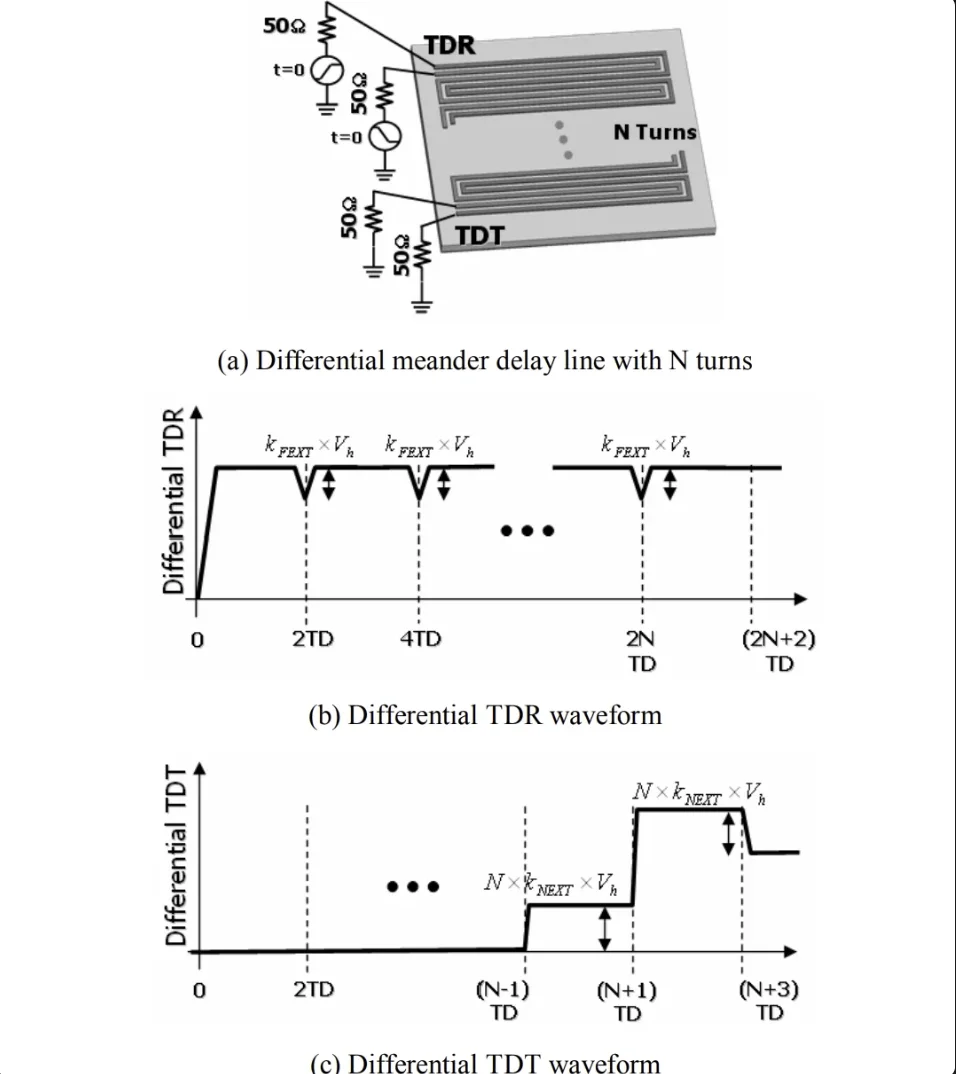

Hello Baluncore,I have am trying to visualise this situation using a simpler case in another article shown below.
As you can see in the photo taken from the article the Vb and VF pulses are a result of odd mode and even mode being not in the same velocity .
why exactly the pulse shape is because of that?
Thanks.

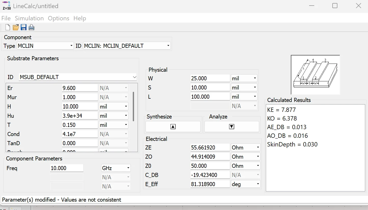

Hello,is there a way to model crosstalk using ADs transmission line models shown below?
Thanks.
