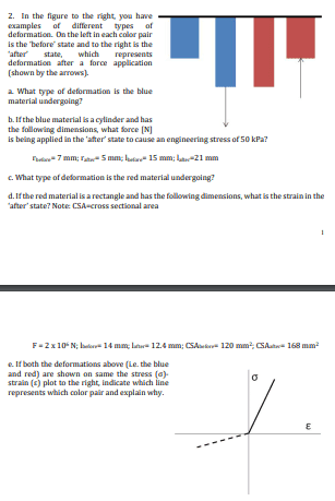

Stress and Strain to cause these deformations
The discussion focuses on the concepts of stress and strain in relation to material deformations. Key points include the identification of elongation, compression, and the application of axial stress formulas. Participants express uncertainty regarding specific parts of the problem, particularly parts b and d, while confirming their understanding of compression in part c. The use of relevant equations for axial stress is emphasized as crucial for solving the problems presented.

refer to picture
stress=F/A
strain=delta l/l
241293
So I got a is elongation.
For part b and d, I am unsure where to start.
For c, i got compression
and for e, I put that the dotted line is the red block

You have noted the the formula for axial stress in your relevant equations.
