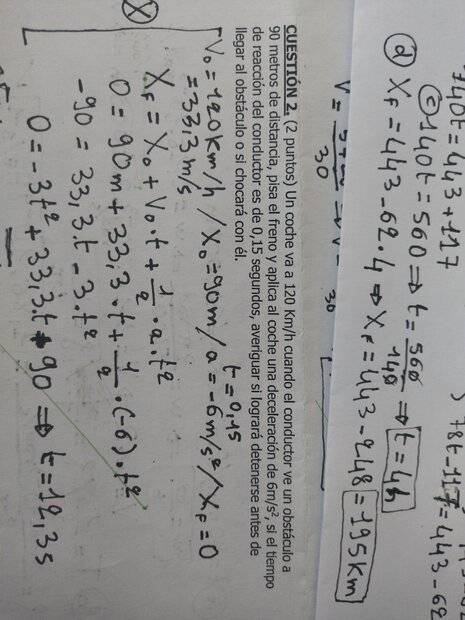

A car going 120 km / h when the driver sees an obstacle to 90 meters away, step on the brake and the car applies to deceleration of 6 m / s ?, if the reaction time of the driver is 0.15 seconds to figure out whether it will stop before reaching the obstacle or collide with him. (using the formulas of cinematics, movements)
i tried but i wasn't able, maybe i choose the wrong formulas in the wrong time.

Okay, i will tell you the problem, i had the exam, i got literally a 4,5/10, many exercises similar to this are all false, including this one, i don't have the exam with me, the teacher said that she will do a recuperation to the most of the class with similar questions, so i need to know how to answer it correctly, including an explanation if it's possible to understand it.

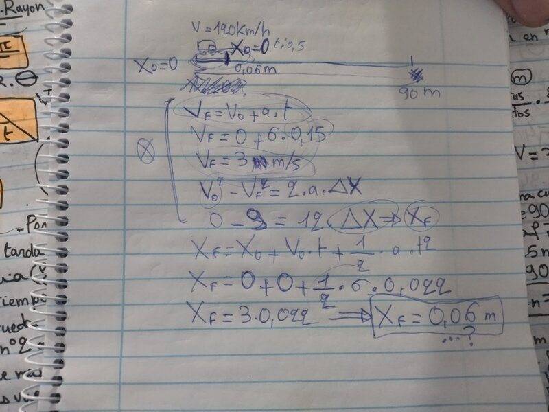

i only took a picture of it in class, you can see that i may start with the wrong formula... but i didn't took a whole picture (It's in spanish btw since I'm from there)
Before trying to find a formula that will give you the answer, you need to have a strategy. What is your strategy here? It looks like you tried to calculate the time it will for the car to travel the 90 m to the obstacle under constant deceleration. That doesn't help much, unless you have a strategy in place that tells you what to do with it once you have it.
Also, you did not take into account the reaction time of 0.15 s. How does that figure into the picture? Think about all this and come up with a strategy, no equations - no numbers, just words. Start with "I will first find ##\dots~##"
Furthermore, please be considerate to those who are trying to help you and post your pictures in their proper orientation.

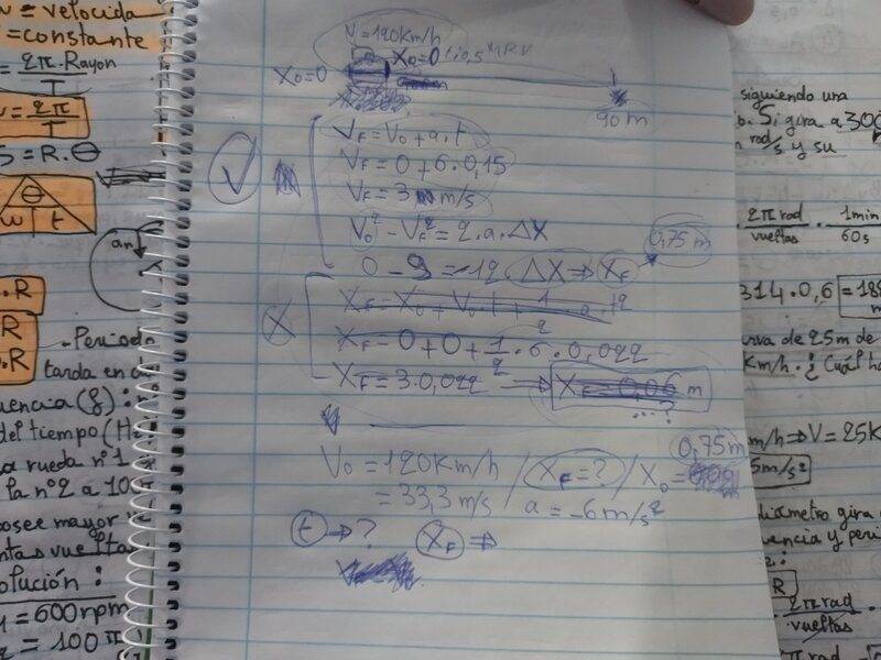

Okay so, the first thing that i did in this picture i think it's correct, the second one maybe wrong, if we suppose that the Xo = 0'75 m / Vo = 120km/h = 33'3 m/s / a = -6m/s² (since the velocity is not augmented). so we need to search for two things: the time and the final distance. please correct me if I'm wrong.

The first thing you did does not look correct. Ask yourself: "before the driver can react, can they accelerate?"

oh my God no, the driver can't. But if it isn't this formula, then am i going to use the normal formula of V = d/t ??
Really?
You have plugged in ##v_0=0, a=6m/s^2, t=0.15s##. 0.15s is the driver's reaction time. What does that mean? What is happening during that time?
How you calculated 0.15 x 6 = 3 is also a cause for concern.

yeah you're totally right, Vo = 33,3 m/s
And what is a during that time?
a = 0 ??

Right. So what is ##v_f## after the 0.15s?
Hmm I'm not sure, 33,3 m/s ?

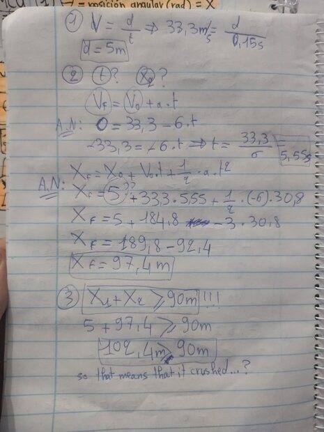

Ok I said I will not post further but can't resist. I ll give you two big hints that are essentially a kind of high level strategy that @kuruman talked about. Let's see if you can fill the in between details:
1) For the first 0.15seconds the car does motion (because the driver hasnt yet pressed the break pedal) with constant speed ##v_0=120km/h##. So calculate the distance ##X_1## that the car travels in the first 0.15seconds
2) After that the car does motion with constant acceleration (or we should say deceleration to be 100% accurate), it is kind of like motion in free fall only that it is horizontal and the deceleration is not g=-10m/s^2 but it is a=-6m/s^2. Calculate the distance ##X_2## that the car travels till it stops. The starting velocity here is still ##v_0=120km/h## and you should take as final velocity ##v_f=0## (that is when the car stops).
3) IF ##X_1+X_2\geq 90m## then the car collides with the obstacle. if ##X_1+X_2<90m## then the car doesn't collide.

Okay, after you told me all what i need to do I'm still not even sure if i did it correctly, is it correct ?? please correct me if I'm wrong.

That initial distance of ##5m## seems to have been included three times! Twice would be too many, but three times is excessive, I would say!
I think your calculation for ##X_2## is correct. And, given that ##X_2 > 90m## you needn't have worried about the reaction time. Although, you added ##5m## to it.

You did it almost correct, only mistake is that you "double count" the distance d=5m that the car travels during the 0.15second.

Treble count, even!
  • #34
Er no its double lol, He counts it once in step 2 (where he shouldnt) and once in step 3 (where he should).

the second part is correct, I'm confused about the 5m thing, what is wrong about it? since the acceleration is not included, the only way to do it is by using the basic method that we know: V = d/t, do i have to use an another method? Or i have choose the wrong numbers ?
