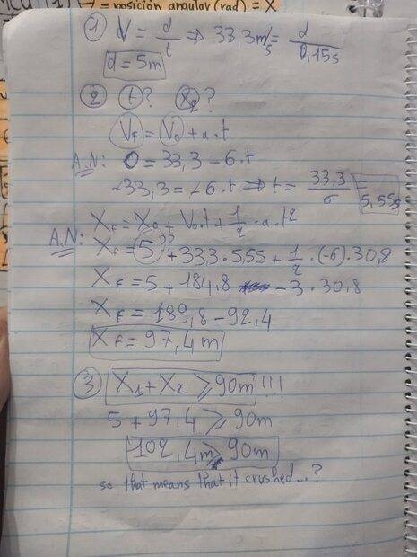

shuumi said:

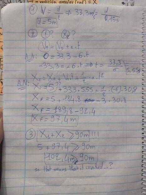

Okay, after you told me all what i need to do I'm still not even sure if i did it correctly, is it correct ?? please correct me if I'm wrong.
That initial distance of ##5m## seems to have been included three times! Twice would be too many, but three times is excessive, I would say!
I think your calculation for ##X_2## is correct. And, given that ##X_2 > 90m## you needn't have worried about the reaction time. Although, you added ##5m## to it.

You did it almost correct, only mistake is that you "double count" the distance d=5m that the car travels during the 0.15second.
Treble count, even!
  • #34
Er no its double lol, He counts it once in step 2 (where he shouldnt) and once in step 3 (where he should).
  • #35
the second part is correct, I'm confused about the 5m thing, what is wrong about it? since the acceleration is not included, the only way to do it is by using the basic method that we know: V = d/t, do i have to use an another method? Or i have choose the wrong numbers ?
what do you mean by double count ? Is like using it two times which was unnecessary ??
  • #37
The ##5m## is correct, but you added it three times instead of once.
  • #38
In the second step, do i have to remove it and replace it to zero ? so in this case, does that mean that the Xo after the acceleration is 0, because i though it's was 5m (if like we talked in general). Is this the wrong thing about 5m ?
  • #39
You calculate ##5m## distance traveled before the brakes are applied. Then you calculate the distance traveled to decelerate to a stop. Then you add them.
You can't add the ##5m## twice. It's knowing that that allows you to organise your equations. Not the other way round.

You're right. I thought we had got up to ##109 \ m## but I misread the ##2## as a ##9##.

Oh so they're like separated equations, i think i understand this exercise now.

The equations of motion change at the end of the first time interval.
for ## x_0 \to x_1 ## the velocity is constant ## v_o = v_1 ##:
$$ \Delta x_{0 \to 1} = v_ot $$
for ## x_1 \to x_2 ## the velocity is changing from ## v_1## to ## v_2 = 0 ##:
$$ v_2^2 - v_1^2 = 2 a \Delta x_{1 \to 2} $$
The total distance traveled is then:
$$ \Delta X = \Delta x_{0 \to 1} + \Delta x_{1 \to 2} = v_o t + \frac{-v_1^2}{2a} $$

Here's an idea. Do the problem with zero reaction time and see what you get.
The answer with ##5m## reaction distance should only be ##5m## longer. If it's ##10m## longer, then you've double counted the ##5m##.
