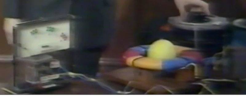

My first thought was aliasing, but I doubt that it would be visible to the live audience at the time and the spin direction is also clearly visible during the final slowing of the rotor. Bearing in mind that the lectures were for young people, including pre-high school students, to be able to explain it in just two lectures would surely mean that the reason behind the effect cannot be too complex.
A single phase motor runs equally well in either direction, but he clearly states that it is a three phase induction motor. I know that a three phase motor will run on at reduced power when it loses one phase. When I look at wye and delta connections, it appears to me that losing one phase leaves a three phase motor running single phase? If so, it has zero starting torque. Is there some way that he could be applying full power to two phases, then varying the third phase that would make the motor reverse?
What was curious to me was it didn't reverse again when he returned below 203 volts.
Then i thought - "If that's just a hollow metal toilet tank float it's got no iron in it. How can those windings support 200 volts with basically an air core ? "
Then i looked at the machine - it looks like a donut surrounding the float .I can't tell which way the turns are oriented on it.
Photo of a demonstration apparatus: a yellow plastic float sits inside a multicolored coil-wound ring on a wooden base, beside a black cylindrical tank and a small instrument box with wires.
Does flux actually go horizontally through the hole in the donut, between same colored windings, as in a real motor ?
Or is this thing a toroid with six windings on it ?
If it's a toroid then flux stays mostly in the horizontal plane an just traverses the toroid?
I think the first step is to discard the notion it's a conventional motor.

Jim, I'm not surprised that it failed to reverse on the way back down. The motor had started backwards (see my earlier post), then it flipped, so was now going in the same direction as the phase sequence. This motor works because the windings have a lot of impedance (because it is small and has many turns) and are wound on an iron core. The rotor is basically anything that you can induce a current into (hence, induction motor) and does not technically need iron. The iron just concentrates the magnetic field and gives superior performance and efficiency, but is not essential. I cannot comment on the flux pattern, because I cannot see how the stator is wound.
I would not discard the idea that it is a conventional motor, because as I stated in my earlier post, this effect can happen in a regular cage motor.
I did notice a speed difference after it reversed. Fifth harmonic is reverse sequence, is it not ?

Given who that guy is, inventor of the linear motor, it's no surprise he has uncanny skills with magnetic fields.
His "core" still looks to me like a toroid with three sets of windings. Look at their orientation , i think they encircle the core just as in a toroidal inductor.
A conventional motor would have its windings oriented to push flux diametrical through the middle of the torus not circumferentially around it.
That is the basis of my remark "not a conventional motor".
The video isn't quite clear enough to say for certain how they're oriented. So i could be all wet on this one...
We're used to thinking of a toroid as completely containing the flux.. So my mind immediately lept to the conclusion it was a conventional motor with diametric flux.
But if so, how does it support 200 volts with no iron in the rotor? Must have enough turns to support it with air core. I wish he'd shown current we'd know if he was saturating his core..
That the instantaneous current in the windings differs between the colored phases says the condition for total confinement of flux to a toroidal core is not met. So i think his "motor" is more a conducting sphere in a time varying field that's tangential to the windings of a leaky toroid, if you will. .A search on "Conducting sphere in a magnetic field" produces scholarly articles . I didn't find one that i could apply, perhaps your Vector Calculus is fresher than mine.. But maybe that's why he says he can't explain it quickly ?

It’s a float from a ballcock (stop giggling at the back). A thin, hollow brass sphere. He says it at the end of the demonstration.
Let me make some guesses and assumptions.
1. It is not a trick.
2. The supply frequency remains constant. The phase connections are not changed.
3. The motor reverses direction once when the voltage is increased through a critical value.
4. The rotor is a light weight, thin-walled, non-magnetic, metal sphere.
5. The spherical rotor will not saturate, but the surface currents may have a harmonic dependent phase delay.
6. The toroid has six windings which form a six pole field. The current in each coil creates a flux that is mismatched where two coils meet. The flux difference is released at the coil junctions as a magnetic pole. That leaked flux then travels out of the toroid, inducing a perpendicular current, (axial), in the surface of the sphere. The induced currents in the sphere are balanced so they form circumferential currents in the rotational axis regions away from the core. The induced currents sum to zero about the axis. By picking the phase, the step change in coil current, i, can be made to vary sinusoidally, with differential currents from +2i to -2i.
7. The toroid has a magnetic core. That could be an iron powder core made in 6 parts, one for each coil, each curved through 60°. They are then glued together, end to end, to make 360°. There may be something at the junction that aids the release of the magnetic field difference. An alternative core could be a bundled coil of one insulated iron wire, like a hedgehog transformer core, but much more orderly. That would give the phase windings something to magnetise, to reduce the current at higher voltages.
8. What will happen if the core saturates at higher voltages? Will odd harmonic distortion change to a reversed direction harmonic?
