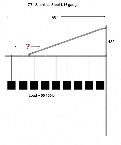

I'm building a clothing rack that swings out of the way. It's ideally made of 7/8" (or possibly 1") stainless steel tube, with 1/16" thickness and will sit on a 3" bearing (lazy susan) that supports 200lb. The top is firmly attached to a stud in the sloped ceiling. It needs to hold up something more than 50 lb (5 feet of clothing).
There is a support bar that starts about 18" above the clothing bar. I'd like to position the support bar correctly to balance the load on either side.
I have no idea how to determine the optimal point of support to balance the load (minimizing risk of collapse). It will obviously be between 30" (midpoint) and 60" (endpoint) from the upright.
For all purposes I'd position it at or very close to the very end between 45'-55' . You will have two load bearing points on the vertical rod, the weight at the farthest end of your horizontal rod will impart its maximum pressure on the vertical rod right at the joint 18 inches down so the farther out you put your angular support rod the less pressure you will have at the end of the horizontal joint. You want it to support a load like a crane or counter leaver long gate... if the top and bottom of your vertical rod are securely fastened then you shouldn't have a problem supporting 50lbs at any point on that rig. 1/16 tubing is very strong

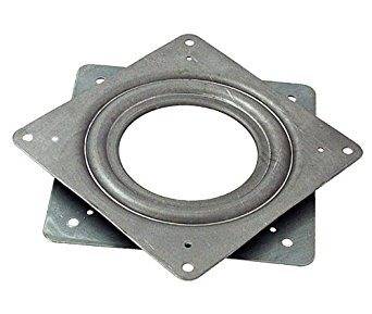

Just bought a couple of 3" lazy susans to act as bearings top & bottom.
Would've liked them smaller but this is all Lee Valley Tools had.
As long as you have a way of attaching the tubing on center of your bearings they should work.

Yeah, it's just that it'll be a disc 2√3 inches across.

I would suggest running the top diagonal to the end of the rod and then determining the rod center point deflection by analyzing it as a simply supported beam with a 100 lb distributed load to see if you need to place an intervening vertical member between the rod and the diagonal at that center point to prevent excessive rod center sagging under load.
As for the vertical support, resolve the diagonal end load into its vertical and horizontal components at the the horizontal rod end; and, then determine the vertical pole"s required diameter by analyzing it as a simply supported beam with the horizontal load component as a concentrated lateral load at the horizontal beam connection point height. This will also give you the horizontal reaction forces on the bottom turn table and the top pole socket connections.

The only issue to consider (for positioning the tie), is the bending of the horizontal member.
Both the thrust of the horizontal member against the vertical pole, and the horizontal component of the tension in the diagonal support (again trying to bend the vertical pole) are independent of the position of the diagonal support. They are determined by the load on the horizontal and the 18".
The tension in the diagonal decreases as its angle to the vertical increases, but once you are half way, you're within 10% of the tension at the end.
My guess is (as yours) to have the tie 2/3 to 3/4along the horizontal, with the cantilever equal to or slightly less than half the beam, but I'm really not familiar with beam calculations. Psychologically I think you will put heavier items near the vertical support and lighter items towards the end, so perhaps the cantilever will tend to have a lower load than the beam and 2/3 is the right spot.
Put the support at the outer end of the horizontal tube. As Merlin pointed out, the diagonal tension is minimal there. If the clothes weigh F and are evenly distributed, with L for the length of the horizontal tube and H for the vertical support, the downward force at the outer end is F/2, horizontal force is F*L/H, and diagonal tension will be F*sqrt(1+L2/H2). The bending moment in the center of the horizontal tube will be F*L/4, and for the vertical support it will be F*L. Assuming you use the same tubing for the horizontal and vertical members, the horizontal member may be safely ignored.
Given your numbers and neglecting the weight of the tubing, we get
  • diagonal tension: 174 lbf = 774 N
  • vertical bending moment: 250 lb·ft = 339 N·m
You'll want a safety factor of at least 2, better 3, so triple those numbers. The diagonal member shouldn't be a problem. I'm very skeptical about the bending moment, though. You better look for a data sheet, or perform a test.

I have done some of the analysis I recommended for your design. The key issue does become the cantilever load on the supporting pole. The beam analyse are based upon the beam equations presented in Machinery's Handbook, 22nd Edition. I have this on an Excel file but don't know how to attach that or a jpeg scan to this post so if you know how I can do either of those please let me know. This analysis is for the diagonal support to connect to the end of the clothes bar and due to excessive .48 inch sagging on the clothes bar I recommend the vertical tie be added between the bar and the support diagonal member at the center point of the bar.
I used an estimated 80 inch total pole height and have specified a 1 1/2 x .125 tubing size for the support pole to reduce the side deflection due to the clothes bar's cantilever loading to 0.15 inches. All other is as specified on your first post. If you would like the Excel file for your own study then tell me how I can get to you; otherwise, if you want to see the effects of any changes to the frame dimensions or tubing then tell me what they are and I will run the analysis and give you the results.

I have updated the calculation sheet to reflect your current dimensions and tubing size. As for the recommended midpoint connection between the diagonal and the clothing bar, assuming you are using the same 1" tubing for the diagonal, then only a 9" length of the 1" tubing plus 2 of the same type of connector you are using for the bar to pole connection should be required for that added brace.
If I have done it correctly the Excel analysis sheet is attached below

I really should have highlighted the primary input cells. Basically, at this point in your project the primary variables that could be adjusted are the tubing sizes and wall thicknesses; but, if you are locked in on these, then it is just some information that show where your design does not exceed the stress limits of your tubing and alert you to potential problem areas such as the need for additional bracing on the clothing bar.
As far as, the need for the that brace, it will clearly add cost, but, even more critical than the deflection shown is that the calculation is based on an absolutely evenly distributed load along the bar; and, a concentration of heavier clothing in center area of the clothing bar can significantly increase the tubing bending stress at that point and potentially result in a buckling failure and a sharp bend in the bar at that point.
While it might not have the appearance you might like, a much less expensive alternative brace that would be as effective as using tubing and fittings would be to use a length of SST flat bar bolted to simple sheet metal wrap around clamps on each bar.
