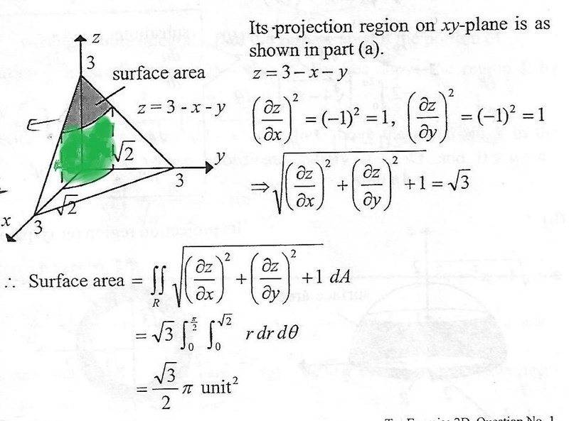

Find the surface area of portion of plane x + y + z = 3 that lies above the disc (x^2) + (y^2) < 2 in the first octant ...
Here's the solution provided by the author ...
I think it's wrong ... I think it should be the green coloured area + the black area ...
If it's only the black area , then the problem is find the surface area of portion of plane x + y + z = 3 that lies above the cylinder (x^2) + (y^2) < 2 in the first octant..
Image here
  • Handwritten solution for surface area of z = 3 - x - y over a quarter-circle projection of radius root 2 on the xy-plane, with a 3D sketch of the tetrahedron-like region and the integral sqrt3 times double integral of r dr dtheta giving sqrt3 pi over 2 square units.
No, it's just the black area.
That's not what they wrote. The disc they described consists of all the points in the x-y plane that lie inside the circle ##x^2 + y^2 = 2##.

The disc here refers to the circle with radius 2 lie on the xy plane where z = 0?
Almost -- the radius is ##\sqrt{2}##. And yes, the disc is in the x-y plane.
