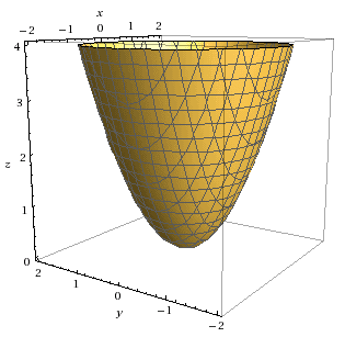

The paraboloid looks like this:
The plane $z=2$ slices through it.
As a result you might visualize the bottom part of the cone sliced off, forming a bounded volume. The surface of this sliced off volume has 2 components: the paraboloid part at the bottom and the plane part at the top.

The actual intersection of those surfaces is the circle $x^2+y^2=2, z=2$.
Now compare the paraboloid to a cup.
We fill it with water up to the level z=2.
Then the surface of the water volume - all around - is the surface that is generated by the intersection.
We do not call this surface an intersection though.

where $\mathbf{r}(x,y)$ describes the surface $S$.
What is $\mathbf{r}(x,y)$ in our case? (Thinking)
That would be:
$$\mathbf{r}(x,y) = x \hat \imath + y \hat \jmath + (x^2+y^2) \hat k$$
which is a parametric expression for the paraboloid. (Smile)
I like Serena said:
That would be:
I tried it now with this formula and that's what I got:
$$A=\iint_T\left \| \frac{\partial{r}}{\partial{x}} \times \frac{\partial{r}}{\partial{y}}\right \| dxdy=\iint_T \sqrt{4x^2+4y^2+1}dxdy$$
$x=r \cos{\theta}$, $y=r \sin{\theta}$
$$A=\int_0^{\sqrt{2}} \int_0^{2 \pi} \sqrt{4r^2 \cos^2{\theta}+4r^2 \sin^2{\theta}+1} r d \theta dr=\int_0^{\sqrt{2}} \int_0^{2 \pi} \sqrt{4r^2+1} r d \theta dr=\int_0^{\sqrt{2}} 2 \pi r \sqrt{4r^2+1} dr$$
$u=4r^2+1 \Rightarrow du=8dr$
$r=0 \to u=1$
$r=\sqrt{2} \to u=9$
$$A=\int_1^9 2 \pi \sqrt{u}\frac{du}{8}=\frac{\pi}{4}\int_1^9\sqrt{u}du=\frac{\pi}{4}\frac{2}{3}u^{\frac{3}{2}}|_1^9=\frac{26\pi}{6}$$
Is it right?? (Whew) (Thinking)
$r=0 \to u=1$
Yep. All correct. (Smile)
Erm... except for the $du=8dr$, which should be $du=8rdr$. :eek:
Apparently that is what you used anyway. (Mmm)
