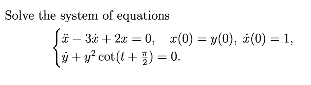

Solve the system of differential equations
x''-3x'+2x = 0 , x(0)= u
y'+y^2cot(t + pi/2)=0
The first equation leads to x = ae^2t + be^t
and the second equation leads to y=[1/(ln(sint+pi/2)+c)]
this corresponds to the system
a+b=1/c
2a+b=1
which has infinitely many solutions. what am I missing here?

You have no initial condition for ##y(0)## so you get a set of solutions. All you can do is express ##a,b## in terms of ##c##.

Okay, then
a = 1-(1/c)
b = (2/c) - 1
and the solution is
x = ((1-(1/c))e^2t + ((2/c)-1)e^t
y = 1/[ln(sint+pi/2)+c]
At least I don't see what else could be done without additional information. The second equation is not defined at ##t=0## but that doesn't mean that ##y## isn't defined. But we do not know ##\dot{y}(0)##, so we cannot perform any limit considerations.

Doesn't look like a system of equations to me. It's two independent equations sharing a common initial value. I strongly suspect a misprint.
Thats what i thought at my first glance too, but then i realized that the coupling is in the initial condition, which creates a coupling in the constants that appear in the two solutions.
Sure, but the process of solving each is completely independent of the other. More socially distanced than coupled.
Well i kind of agree, the processes of solving are independent (up to the constants) however the two solutions are coupled because the constants that appear in them are coupled.
