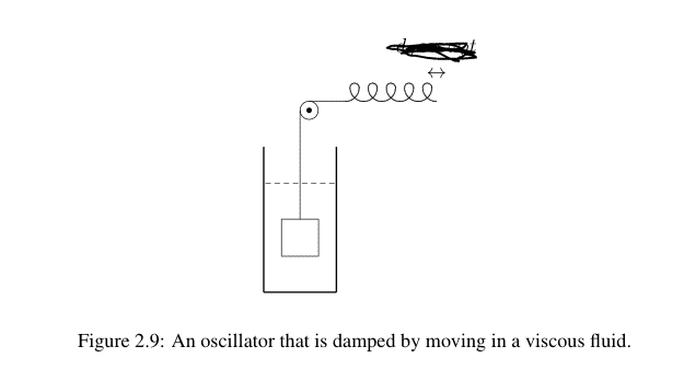

The displacement of the end of a spring varies as
, the block on the spring is subject to a viscous force proportional to the velocity. Spring stiffness k.
(a)Find the displacement of the block:
(b)When γ -> 0
First of all, i have a doubt i we could start saying the component of the force is the imaginary component, seems plausible?
Anyway:
## x'' + yx' + wo²*x = wo²*d*sin(wt) ##
## sin(wt) = cos(wt + 3pi/2) ## , x is Real part of z
## z'' + yz' + wo²z = wo²*d*e^{(wt + 3pi/2)i} ##
## Solving for z = A*e^{i(wt + 3pi/2)) ##
(a)X=
(b)X =
That's ok?

You mention a parameter ##y##. But you have not defined it. Presumably you mean for it to denote the viscosity. Naturally, this viscosity will be positive.
You mention a parameter ##o## which is always used as ##o^2##. Plausibly you mean for this to denote the spring constant k.
You use a parameter ##d##. But the parameter that is defined is ##d_0##.
You use a parameter ##\omega##. But the parameter that is defined is ##\omega_d##.
Can you rewrite your first equation after having defined the variables it uses?

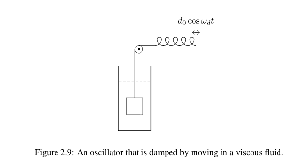

i tried to do the post in the cellphone, but made a huge confusion, it translate the message to my language, sorry. i deleted it. Anyway, now i think is better:
The block is attached to a cord that runs
over a pulley and is attached to a spring, as shown
The displacement of the end of the spring, subject to a driving force, varies as
## d*sin(w*t) ##
## t>=0 ##
and the block, which is attached to the spring, is subject to a viscous force proportional to the velocity, Fs.
## Fs = -m*y*v ##
Where v is the velocity of the body
and y is the damping coefficient [T^´-1]
m is the body mass.
and k is the spring stiffness
(b)When γ -> 0​

Perhaps someone can explain to me the setup in #4. As far as I can tell, if we define the coordinate ##y## of the block as the distance below the horizontal level of the spring, then our equation of motion is$$mg - T - c\dot{y} = m\ddot{y}$$Now if we define another coordinate ##x## which is the horizontal distance of the end of the spring from the peg, that$$x = d + d_0\sin{\omega_d t}$$where ##d## is the average ##x## coordinate of the end of the spring. Then the total length of the spring at any given time is (assuming the whole wire is the spring, it shouldn't matter),$$L(t) = y + d + d_0\sin{\omega t}$$The force ##T## must then be $$T = k\delta(t) = k(L(t) - L_0) = k(y + d + d_0\sin{\omega t} - L_0)$$and finally our equation of motion is$$mg - k(d-L_0) - kd_0\sin{\omega t} = m\ddot{y} + c\dot{y} + ky$$Have I got that right, or did I miss something?
If we were going to include gravity, we might consider buoyancy as well. But I see no need to include either. They are both equivalent to a fixed external force. Since we already have a spring in the problem, a fixed external force is equivalent to a change in the starting position.
We are not told the relaxed length of the spring. So we may as well do ourselves a favor and assume that the problem starts with the body at rest in its equilibrium position before the driver starts driving the spring.
Thanks, yes I forgot about buoyancy o_O. So I will recast the equation in terms of a constant force plus that due to the tension$$f - T = m\ddot{y} + c\dot{y}$$How to deal with the term ##T## in a simple manner still does not seem obvious to me. In my original setup$$T = k(y + d + d_0\sin{\omega t} - l_0)$$maybe you would like to express$$\dot{T} = k\dot{y} + d\omega \cos{\omega t}$$and insert$$-k\dot{y} - d\omega \cos{\omega t} = m\dddot{y} + c\ddot{y}$$ $$m\dddot{y} + c\ddot{y} + k\dot{y} = - d \omega \cos{\omega t}$$which is now a third order equation which should still yield to a standard constant coefficients method of solution...

@LCSphysicist I think you are on track for the differential equation you wrote down in the OP, but AFAIK that doesn't describe the scenario given in the question?
Sorry... what is AFAIK?
Oh, it's just "as far as I know" :wink:. I got that$$m\dddot{y} + c\ddot{y} + k\dot{y} = - d_0 \omega_d \cos{\omega_d t}$$
