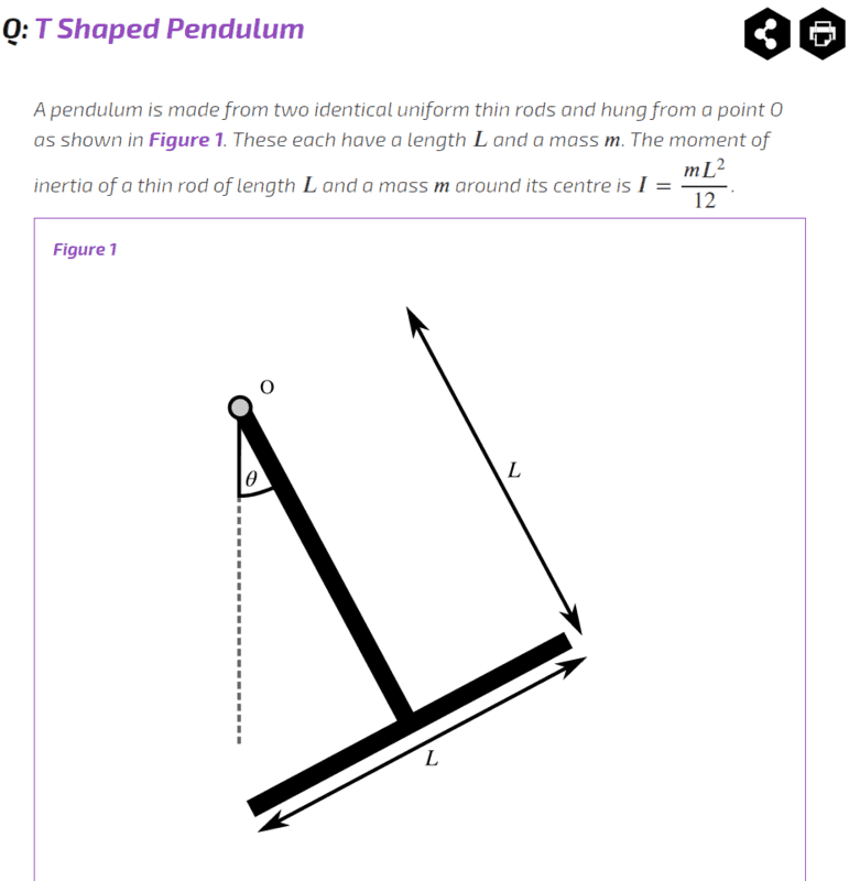

A pendulum is made from two identical uniform thin rods and hung from a point O. These each have a length 𝐿 and a mass 𝑚. The moment of inertia of a thin rod of length 𝐿 and a mass 𝑚 around its centre is 𝐼=𝑚𝐿^2/12.
Part A:Given that 𝐿=31.0cm and 𝑚=100g, what is the moment of inertia of the whole T about the point O?
Part B: What is the potential energy of the pendulum if it is at an angle 𝜃=30.0° to the vertical, if its potential energy is taken to be zero at 𝜃=0°?
Part C: By working out the total energy when the pendulum is in motion, and remembering that this must remain constant, or by using the angular equivalent of Newton's Second Law, find the period of small oscillations of the pendulum.

My answer to part A is correct but for Part B I got an incorrect answer of 0.204J. My working out is sent as an attachment.

Putting your work in an attachment makes it difficult to comment on. In the future, type up your work right here.
You found the location of the center of mass. Compare the initial and final positions of that center of mass. (I don't see where you got the equation you used for "h".)
Hi Doc Al, Thank you for your comment, I appreciate this! I just worked out Part B! I made an error for the "h" equation. Since h=l(1-cosθ) and the position of the centre of mass from the point O is l/4 then the position of the centre of mass from the pivot is 3l/4. Therefore the potential energy is 3/4x0.31x2x0.1x9.81x(1-cos30)=0.0611J(3sf). This is the correct answer for Part B. I am not sure what the outcome would be if I compare the initial and final positions of the centre of mass?
Hi Doc Al, I just finished solving the whole problem, the time period of the pendulum is 1.09s(3sf).

You might not realize it, but that's exactly what you calculated. :smile:
To calculate the change in potential energy you must calculate how high the center of mass raises from its initial position. That's what "h" is. (And you did it.)
