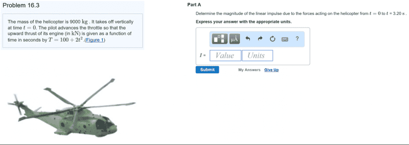

∫ F dt = mv
I have
∫ T -mg dt
= ∫ 100+2t2 - mg dt
= ∫ 100-9000*9.81 +2t2 dt
but then I got negative impulse ...??
nysnacc said:
T=100+2t2
... where the units are ...?
Oh I see 100+ 2t^2 in KN... mg should also in kN
Whatever makes all the units consistent.
