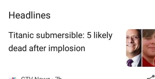

"... likely..." 🤔

DaveC426913 said:
"... likely..." 🤔
There's always a possibility that they were teleported by an alien UFO who foresaw this accident. :')
