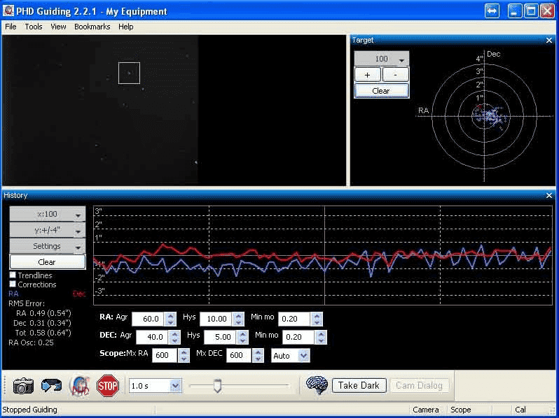

sophiecentaur said:
My idea is merely gathering more relevant information by looking over an extended spatial region; there is a direct correspondence
what more relevant info ??
again, the screenshot from the guiding software ...
PHD Guiding 2.2.1 software window showing a dark guide camera view with a square selection box around one star, a target plot with concentric rings, and a history graph of RA and Dec guiding errors.
You can see multiple stars in that shot, you can select whichever one you like.
It doesn't matter which one you select as they are all moving with the same motion(s).
There are 3 motions...
1) the natural motion across the sky
2) motion that strays from that natural motion because of the mount polar alignment inaccuracies ( I have already mentioned this in a previous post)
3) motion that strays from that natural motion because of the mount motor gear meshing inaccuracies ( I have already mentioned this in a previous post)
Guiding, be it auto or manual, aims to remove the inaccuracies of #2 and #3 so as to get the scope tracking the natural motion of the guide star (and as a result, the object being imaged) as accurately as possible
sophiecentaur said:
The process is not as obvious as the way a single star guider uses. The conventional guider can only work for a star that is bright enough for a simple algorithm to work. Is it not obvious that there is far more information available in the total field than in the position of just one star?
yet again, you don't need multiple stars when just one star provides the same amount of info, there is nothing to be gained by tracking multiple stars
If there was, I'm sure they would be doing it already. Auto-guiding has been around long enough for that to be realized if it was of use.D
