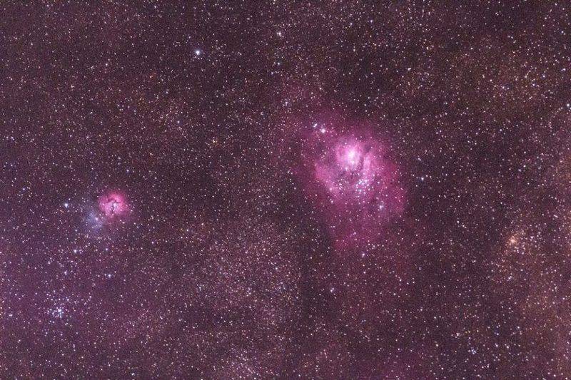

Lets take a practical example and see the difference between stacking and a single image.
One of the major purposes of doing this is to improve the signal to noise ratio. The noise is
primarily sensor thermal noise that starts to come through because there isn't enough signal noise to overcome it because we are imaging in very low light and usually high ISO settings > 1000.
Because noise is random in its appearance and location in the exposure, but the signal -- the stars nebula etc isn't. The signal level is compounded and improved where the noise tends to cancel out.

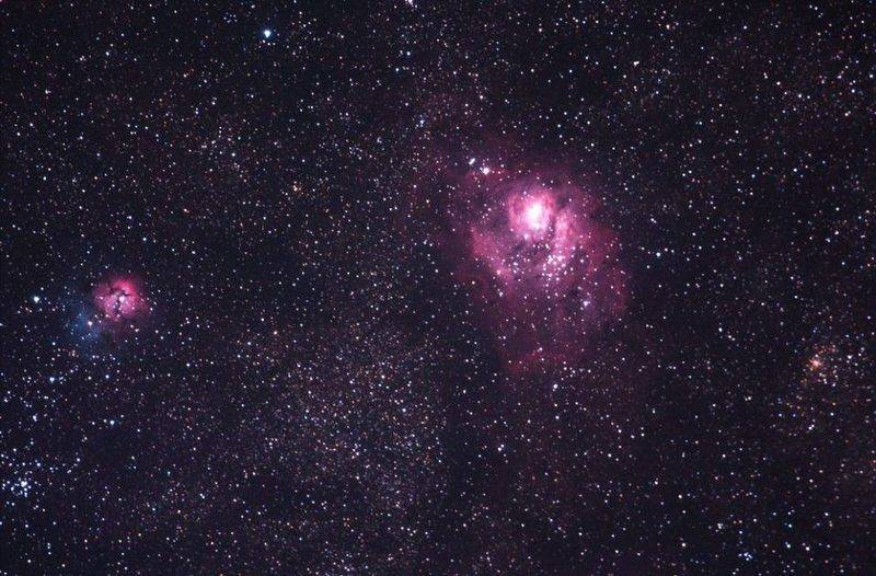

This first image is a single 30 sec exposure with a 400mm lens at f5.6 and ISO 3200
The camera is a Canon 700D that I have modded by removing one of the filter elements
that limits IR/UV and colour range ... it improves the sensitivity to the red end of the spectrum
the 2 main objects are ... to the left M20 - the Trifid Nebula and to the right M8 - the Lagoon Nebula
Long-exposure deep-sky photo of a star field with two pink emission nebulae, a small one at left and a larger, brighter one at right, with a faint dusty background.
You can see there is a bit of a pinkish hue to the image as a result of the extra red sensitivity
now here is 6 separate exposures ( all same settings) taken one after the other and stacked in DSS
Long-exposure astrophotograph of a dense star field with two pink emission nebulae, one large and bright on the right and a smaller one on the left.
The result is glaringly obvious. I have been able to keep the red hue under control. Have been able to
achieve a much better contrast between the nebulae, stars and the dark background. Also, if you look closely, you can see a definite loss of the fuzzy noise across the whole image ( the noise).
The overall result is much better detail in the imageThere is some initial comments

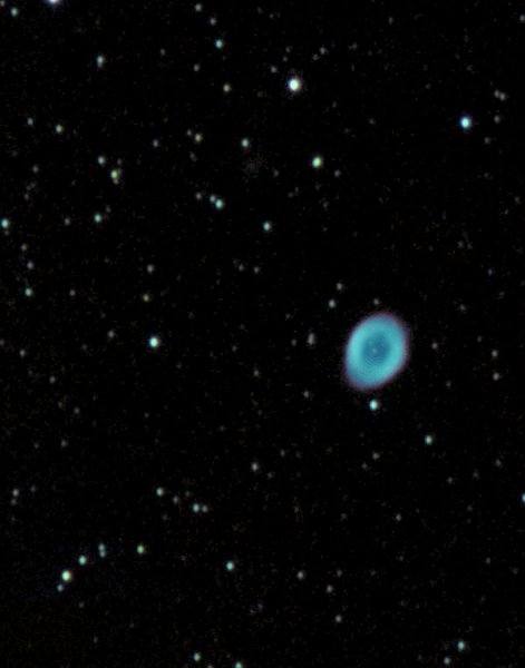

yes, I could see the colour balancing problems you are having. Really shouldn't be that green huh :wink:
the galaxy and all your stars are a bit off-colour ... experiment with the colour temperature settings a bit
be careful not to push the vibrance or saturation ...

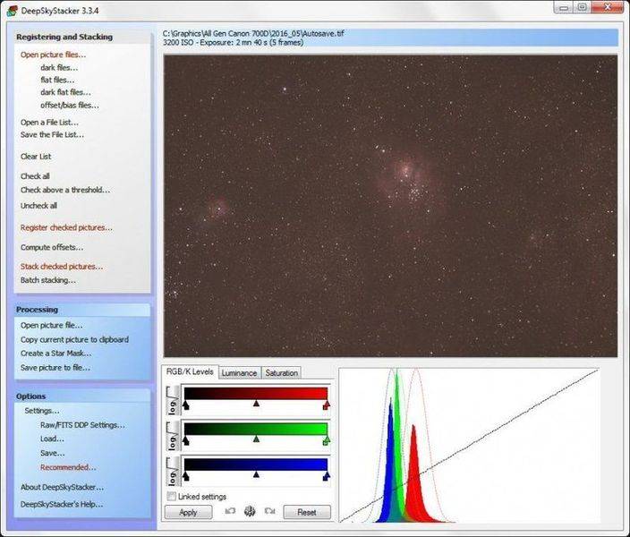

here's the 5 image stack if that above image before being exported to Lightroom
as you can see it looks pretty blah and it has more detail than some stacks do
Screenshot of the DeepSkyStacker 3.3.4 window showing a stacked deep-sky astrophotograph of a star field with a reddish nebula, and the RGB/K Levels panel with histogram.

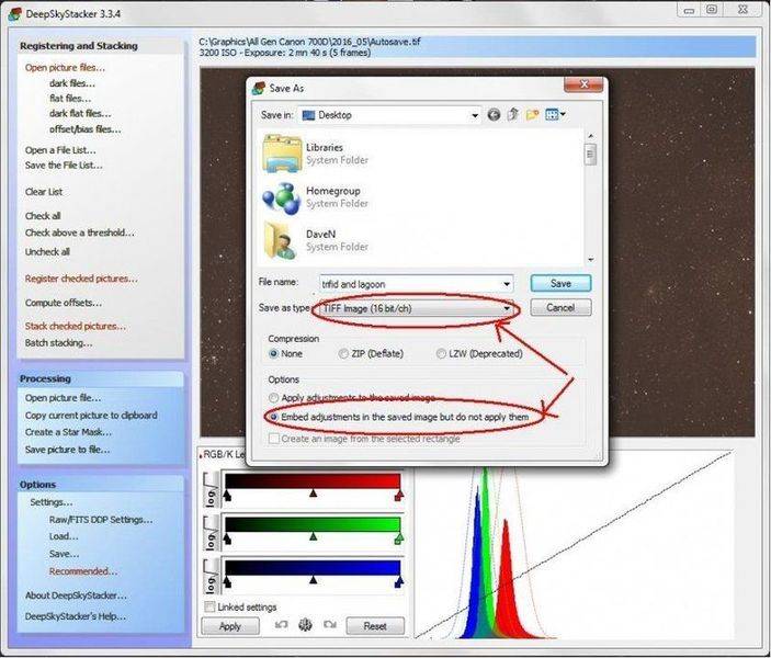

99% of us don't do colour stretching in DSS either, Rather save the tiff file and open it in your fav image editor
save it like this ...
DeepSkyStacker 3.3.4 Save As dialog over a starry astrophotograph; Save as type is set to TIFF Image (16 bit/ch) and Embed adjustments in the saved image but do not apply them is selected, both circled in red.
time for bed ... hopefully tomorrow nite I can delve into the use of DSS a little more and give links to some good tutorials

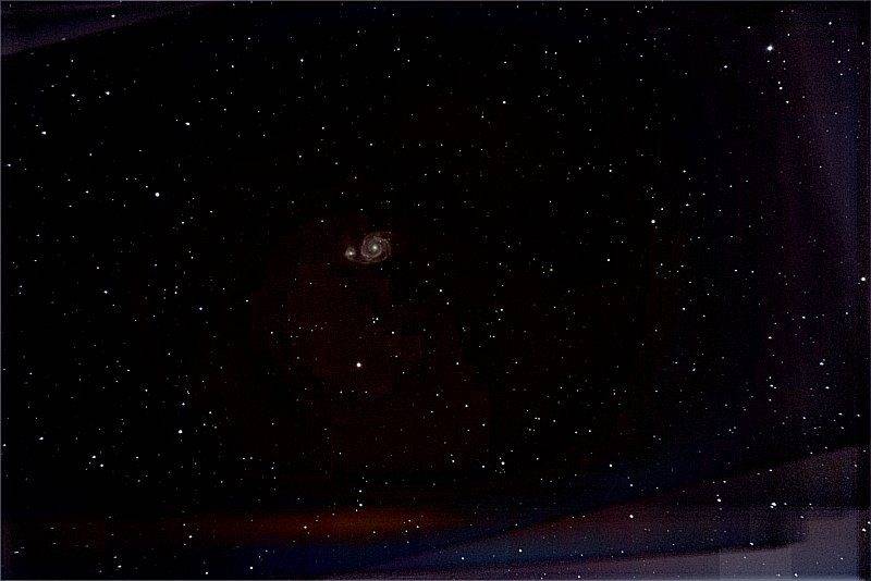

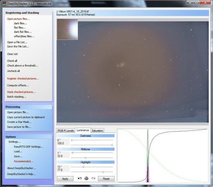

Ok, here are some screengrabs- these are not my best, but they are not the worst, either. I don't claim to be an expert user, by the way- let me know if I'm totally off-base. Typically, after stacking I get this:
Screenshot of DeepSkyStacker 3.3.2 showing a dark, nearly black stacked astrophoto of M51 with a few faint stars, and the RGB/K Levels panel with a histogram spiking near black.
Note the extreme slenderness (?) of the background histogram as compared to davenn's. I don't understand the broad curve (in green), the actual green histogram is lying on top of the red and blue ones. Since I can't work with 32-bit images, the first step is to compress this into 16-bits. What I do is a version of Dolby noise reduction- I compress at the high end to maximize separation between the background and faint objects:
Screenshot of DeepSkyStacker 3.3.2 showing a stacked deep-sky image of M51 with a faint galaxy at centre, and the Luminance tab with its curve and histogram.

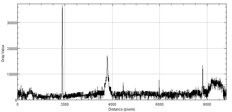

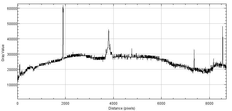

Some explanation is in order- there is a lot going on here. First, the obvious, is the spatial chromatism- this is (likely) caused by the chromatic differences between my flat and data images. Generally, I try and tweak the color sliders to make the bright stars white (colorless), but it's really hard to do this accurately, given the lack of fine control on the slider bars. The best I can manage will leave the center close to grey and the edges a distinct blue color.
Next is the threshold-like appearance of the luminance map. This is the intensity compression: my images often have objects spanning 10 or 11 magnitudes (or more, if there's a bright star in the field of view). I can reliably image down to magnitude 15 objects, so I want the background to be around magnitude 17 or so. That intensity range (magnitude 5 through 17) is very nearly 16-bits worth. The mapping should not be linear, but preserve the logarithmic scale as best as possible. Remember, your screen can only display 255 discrete grey values- so I still have a lot more compression to perform. After saving this 16-bit image (16 bits per channel) I import into ImageJ for further processing. To give you an idea of the SNR of this image, here's a linescan across the diagonal, where I've nicked a couple of stars and the center of M51:
Line graph of gray value against distance in pixels, showing a noisy intensity profile with several sharp spikes, including a tall peak near 2000 pixels and a smaller one near 3800.
The luminance is fairly constant across the image, which is good. ImageJ has a background subtraction routine built-in, and after that step I get this intensity profile:
Line graph of gray value against distance in pixels, with sharp spikes near 1900 and 3700 pixels and smaller peaks near 4500, 6000 and 7800 pixels, over a noisy baseline.

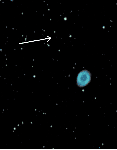

But the image will look terrible because I haven't (yet) compressed it to 8-bits:
Dark astrophotograph of a star field with a small, faint spiral galaxy near the centre, showing two overlapping spiral nuclei.

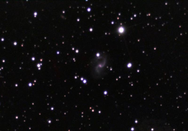

So the next compression step is similar to the 32- to 16-bit compression, but involves more tweaking and fine-tuning. I try and work with the 16-bit image stack as much as possible, but it's all squishy and I come up with different algorithms all the time, but I can eventually get something like this:
Dark star field with a small pair of interacting spiral galaxies near the upper center, with a faint reddish nebulous glow around them and a brighter horizontal band of haze along the bottom.
This is about as far as I can go with ImageJ- there's some additional room for improvement (for example, I can work with a HSB stack and operate on the brightness component to further suppress background), but that's about it. There's still too much green in the midtones, but it's really hard to correct since the whites are white and the blacks are black. What's not apparent on these downsized images is the posterization that occurs way back when I compress to 16 bits per channel. I don't have any good examples to show here, but basically, what appears to be a step change of 1 or 2 grey values on the monitor actually corresponds to intensity changes of 500 or 1000 in the 16-bit image; background subtraction fails on these 'steps'.
OK and sometimes, before stretching you may not see much more. Again don't panic too much, don't do any processing in DSS
as you obviously started to do in the second screenshot. Rather Save the file as a 16 bit TIFF with the setting I have shown in that screenshot of my earlier post

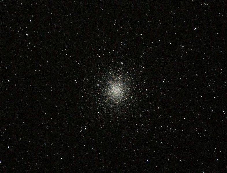

just as a comparison ...
here is a single 30 sec exposure of the Omega Centauri globular cluster ...
Dense star field with a bright, roughly round globular star cluster near the centre, its stars concentrated toward a bright core and fading outward against a black background.
note the lack of all the brownish blobbyness that you can see in your image
if you are not doing 1 min or multiple min exposures with that good mount, then you need to get to that point and you will notice a major improvement in your results :smile:
It's going to improve the signal to noise ration greatlyDave

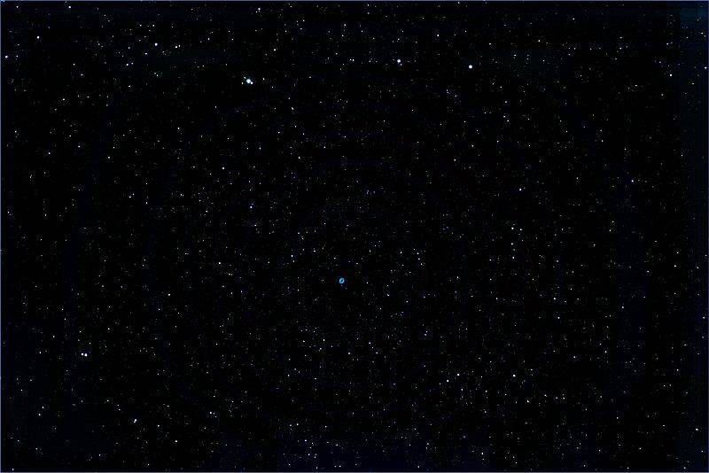

The clouds cleared out for the weekend, two good nights of viewing (C-Town residents had other priorities on Sunday):
Long-exposure astrophotograph of a dense star field with a small, faint blue elliptical nebula near the center.
Long-exposure astrophotograph of a small blue-green planetary nebula with a faint ring structure, surrounded by scattered stars on a black background.
55 minutes of exposure, 10s at a time- my PEC efforts are starting to pay off, now keeping twice the number of images (40% vs. 20%), and my 'efficiency' is up around 15% (from 5%). IC 1296 is barely visible (mag. 14.8), I've previously calculated I need at least 1 hour exposure time to get it above the noise floor.
Andy Resnick said:
If it's so visible at a 30-s exposure, why do you claim to be able to acquire 1-3 minutes single exposures?
Hi Andy, I had missed this response from you
that comment was for you and your unguided EQ mount NOT my Al/Az mount :smile:
nothing to do with that motion on my 30 sec exp ... scroll back a bit further and you will see how the comment related to your systemDave
Andy Resnick said:
The clouds cleared out for the weekend, two good nights of viewing (C-Town residents had other priorities on Sunday):55 minutes of exposure, 10s at a time- my PEC efforts are starting to pay off, now keeping twice the number of images (40% vs. 20%), and my 'efficiency' is up around 15% (from 5%). IC 1296 is barely visible (mag. 14.8), I've previously calculated I need at least 1 hour exposure time to get it above the noise floor.
that's great ...
I'm assuming M57 the ring neb in Lyra ?
I haven't imaged that one and been many years since I last observed it ... late 8's early 90'sDave
PS. EDIT ... that isn't IC1296 as that is a galaxy, you have imaged a planetary nebula and I still think it's M57 ... IC1296 isn't too far away from it

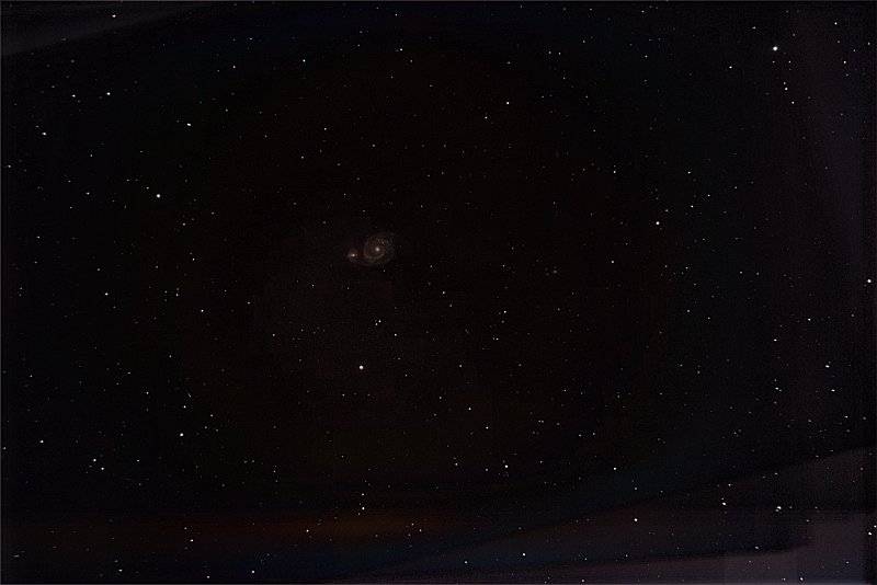

this is IC1296 ...
Deep-sky astrophotograph of a star field with a faint, small spiral galaxy near the centre, showing a pinkish core and dusty arms, with one bright star above and right of it.
OK I see my misunderstanding LOL till I did comparisons of star fields, I didn't realize it was so faint on your image ... so big arrow to hilite it for others reading the thread ...
Astronomical photo of a star field with a white arrow pointing to a faint galaxy near the center, and a bright blue oval planetary nebula with a ring-like glow to the lower right.
