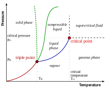

Should it look like as follow?
Pressure versus temperature phase diagram showing solid, liquid, vapour, compressible liquid, gaseous and supercritical fluid regions, with the triple point and critical point marked.

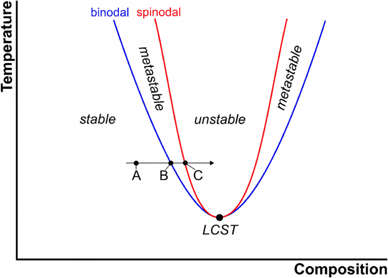

I don't know should the spinodal is drawn like this ?
Phase diagram of temperature against composition showing a blue binodal curve and a red spinodal curve meeting at an LCST critical point; regions labelled stable, metastable and unstable, with points A, B and C on a horizontal arrow at fixed temperature.
