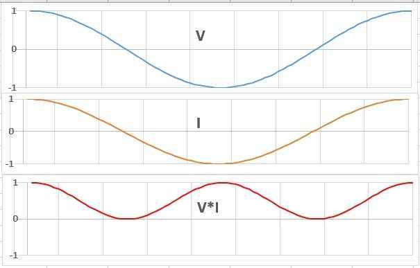

See the PF Insights article, AC Power Analysis: Part 1, Basics
From the article, V(t)*I(t) is the instantaneous power. When V and I are in-phase, V*I is double the fundamental frequency.
