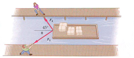

Two crewmen pull a boat through a lock, as shown in Figure 5-25. One crewman pulls with a force of F1 = 115 N at an angle of θ = 36° relative to the forward direction of the raft. The second crewman, on the opposite side of the lock, pulls at an angle of 45°. With what force F2 should the second crewman pull so that the net force of the two crewmen is in the forward direction?
Diagram of a raft on a canal pulled by two people on opposite banks, with forces F1 and F2 drawn as red arrows from the raft, F2 toward the upper bank and F1 toward the lower bank, and a 45° angle marked with theta.

For the net force to be along the canal, the components of force across the river have to be equal.
You were using cos function which would relate to components along the canal.
