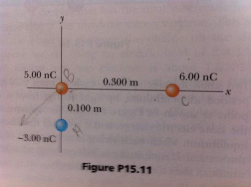

Three charges are arranged as shown in the picture I attached. Find the magnitude and direction of the electrostatic force on the charge at the origin.
I know that Coulomb's Law must be applied.
I've drawn a force diagram with FCB pointing to the left and FAB pointing down. I've also broke the vectors into components using Coulomb's Law and added them together. By doing this, I got 1.42 x 10-5 [itex]\hat{x}[/itex] + 8.54 [itex]\hat{y}[/itex]. From here what do I do to get an answer?
I know the answer is supposed to be 1.38 x 10-5 at 77.5 degrees so I need help with how to get there.
  • Diagram of three point charges on x and y axes: 5.00 nC at the origin, 6.00 nC at 0.300 m along the positive x-axis, and -3.00 nC at 0.100 m below the origin on the negative y-axis.

I solved for these vectors then added them:
FCB=[(9x109|(6x10-9)(5x10-9)|) / (.32)][cos 180][itex]\widehat{x}[/itex] + [(9x109|(6x10-9)(5x10-9)|) / (.32)][sin 180][itex]\widehat{y}[/itex]
FAB=[(9x109|(-3x10-9)(5x10-9)|) / (.12)][cos 198.43][itex]\widehat{x}[/itex] +[(9x109|(-3x10-9)(5x10-9)|) / (.12)][sin 198.43][itex]\widehat{y}[/itex]

where does 198.43° come from? :confused:
Good morning! :smile:
So I plugged the 198.43 degrees in for some reason but that was the angle at which the ball is being pushed by the other balls.
So then in the vectors I had before, I fixed the degree in the second one to 270 degrees but then I get 2.7x10-5[itex]\widehat{x}[/itex] + 0 [itex]\widehat{y}[/itex] and that still does not match the correct answer.
let's see …
it's |-9*10-9 (6*5/.09y + 3*5/.01x)|
= |-9*10-7 (2*5/3y + 3*5/1x)|
= 9*10-7 √(100/9 + 225)
= 9*10-7 √(111.11 + 225)
… hmm, that's not the answer in the book :redface:
(though the angle is correct, isn't it?)
The angle I got isn't even correct. According to the book it should be 77.5 degrees below the -x axis.
