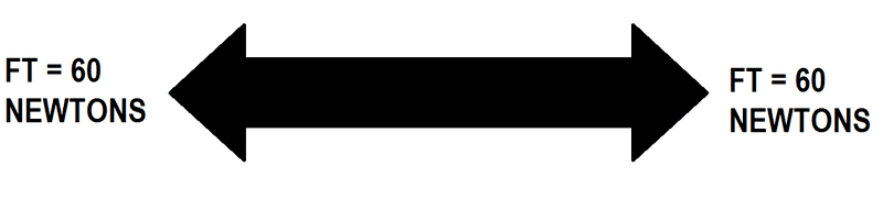

If you have a string being pulled on each end by 60N, what is the total tension in the string?
N/A[/B]
The answer in my textbook says 60N, but it doesn't make a whole lot of sense to me (even though it's obviously right). If you're pulling both ends with 60 Newtons of force, why isn't it 120N of force, total, in the string? Why is it that the tension is only 60N? If one end were tied to a fixed object, and the string was pulled by 60N, then the total tension would also be 60, no? So then do you get the same result from pulling the other end rather than keeping it stationary?
If one end were to pulled by 70N, and the other by 60N, would the total tension be 70?

If you tied one end of the string to the wall, and pulled the other end with a force of 60 N, what is the tension in the string?
The case where the string is being pulled with a force of 60 N from both ends does not result in a tension of 120 N, because forces have magnitude and direction. You can't simply add the two force magnitudes here and ignore that one force is acting in the opposite direction from the other.
In order to determine tension in a string or a bar or whatever, it's best to draw a free body diagram before proceeding with the analysis.
If you tied one end, and pulled the other end with 60 N, the force should be 60 N, right?
I'm not sure how to go about drawing a FBD for this question, but here it is:
If there are two forces of 60 N on each side, then isn't the net force 0? It's obviously not, but I don't see why it isn't.

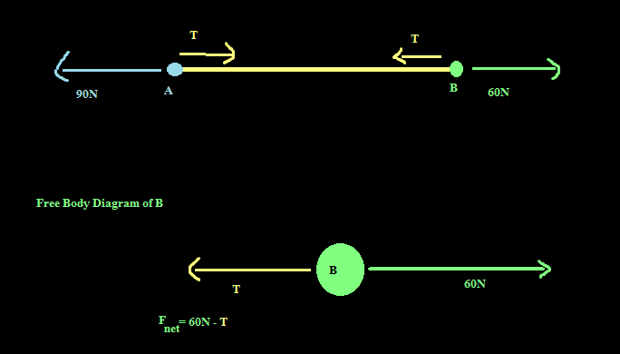

And the net force on B is equal to the mass of B times the accelaration of B. And look, the force exerted on both A and B by the rope is same , i.e., T which is the tension of the rope. According to Hooke's Law, the tension of the rope is proportional to the extension. At some time, the rope completes its extension.And the tension is constant after that. As, the rope doesn't extends anymore, the accelaration of A and B will be same. Keeping these in mind, you may find another equation for A and find out the tension and also the accelaration of the system.
So what would the tension be in that "center" rope, between masses A and B? We would need to assign some arbitrary values for mass and acceleration, right? ↓ I believe you mentioned that here ↓:

Of course the net force is zero. How could it be otherwise? That's the essence of static equilibrium: there's no net force.

This situation is not in equilibrium with only the forces shown. You can't draw a free body diagram to determine the tension here because depending on which diagram you draw, you will get inconsistent results. That's one crucial reason why free body diagrams can be used only when a body is in equilibrium.

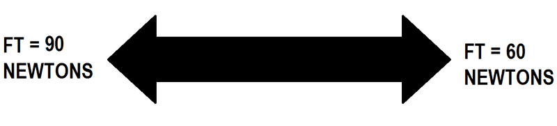

So how would I determine the force of tension in a rope with, say, 90 N of force on the left hand side and 60 N of force on the right hand side? Assuming still a mass-less, and inelastic rope.
Tension is same in every parts of the rope.
In case of inelastic rope, the accelaration in both the ends are same.

Let's consider two cases:
1) A rope is bring pulled at both ends with the same force. 60N, say.
2) A rope is attached to a wall at one end and being pulled with a force of 60N at the other.
What is the difference in these two cases? The answer is there is no difference. Newton's third law tells you that the wall must be pulling the rope with 60N.
Now, let's say that's what we mean by a tension in the rope of 60N. Both ends are being pulled with the same force.
To understand this better think of the rope as a series of links in a chain. Each pair of links is pulling the other with 60N in opposite directions.
So, you have a whole series of these pairs of 60N forces, all the way along the chain.
To take it to the next level, think about the adjacent molecules in the rope. At that level you have a large number of pairs of forces between adjacent molecules all the way along the rope.
That's what tension is and it's always a two-way thing.
