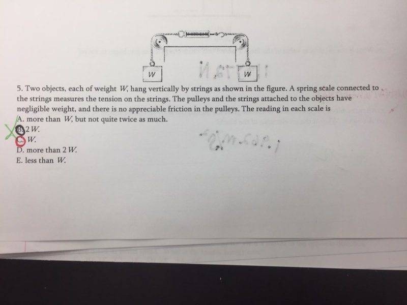

Barrett Long said:
I understand that the tension is equal to W, but, I do not understand why it equals W as oppose to it equaling 2W. I need to have the explanation of why tension would equal W to get points for corrections on my test.
If it was ##2W## each mass would have an unbalanced upward force of ##2W - 1W## acting on it and each would acclerate upwards!

  • #42
Ok so I have a similar homework problem and I've read the thread but I'm still failing to understand. Sorry if it's dumb and repetitive, but if you had a string on a pulley with two weights on each side, each exerting a force of 80N would the tension on the string be the same throughout? Would the centre of the string have a tension of 0?
  • #43
Yes.
Think of the string as made up of a lot of short segments. Each part pulls on each of its neighbours with the same force.
