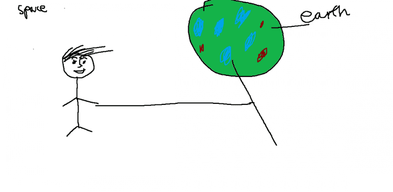

There's two questions about tension(the force), that no matter how much I try to find answers to and understand since the past few days, I'm simply not able to. Any help in this matter would be highly appreciated.
1) If person A and person B are holding a rope, and person A applies 100N of force, he would get a reaction of 100N and the tension in the rope would be 100N. Fair enough. Now, if person B pulls with 100N too, person B would be pulled not only by the reaction force of 100N, but also by the force exerted by person B. In this case, shouldn't the tension be = 200N?
Related sub-question: If a block of 10 kg is hanging from the ceiling, It would be exerting 100N downwards and get a reaction from the rope of 100N, and the ceiling would pull it with 100N too. So shouldn't the tension be 200N?
2) If person A is pulling the string with 100N and person B with 200N, why is the tension in the rope 100N?
I've read somewhere that in a string with negligible mass, this would result in the string slipping off the hands of person A, which makes sense. But why wouldn't that be the case with a string with mass too?

If I'm in space, and I pull a rope with 100N that is just freely floating or even attached to another person, the rope will exert a 100N force on me
Correct but only if B accelerates at the same rate as the rope so he doesn't also apply a force to it. Did you mean to make it that complicated?

So is the reaction provided by the pole or the rope? It could be the rope since in space when it is unattached to something, that's what it does.
Also, what would be the tension in the case that the rope is fixed to another person while being pulled?
The reaction is due to the pole. If the rope were unattached there would be no tension, unless you were accelerating hard enough while holding the rope that (mass of rope) X (rate of acceleration) = 100N.
If the rope is tied to a fixed pole that means the rope isn't accelerating. Therefore the inertia of the rope can't be providing a reaction force. Therefore the reaction force must be provided by the pole.
If you pull on the rope with your hand, the reaction, if any, on the hand, can be provided only by the rope. Your hand is not interacting with anything else but the rope.
The Newton third law pair involving your hand regards the rope and the hand.
The interaction between the rope and the pole is a different interaction, characterized by a different pair of forces. Even if the magnitudes of the forces in the two pair may be equal, these are different forces.
If the rope is not attached, both your force and the reaction of the rope may be very small (zero if the rope is considered massless). But you should realize that not only the "reaction" is zero, your force is zero as well. Both forces in the pair are zero. Or actually small.
Attaching the other end of the rope to a pole you introduce another pair of forces, at the pole end.
This time you can pull the rope with a larger force and the rope will pull you with the same larger force.
So the effect of the pole is to allow you to increase the forces at your end. However this is not the same as saying that the pole produces the reaction force at your hand.

This is the part that confused me. Introduce a new pair of forces at the pole end?
Could you make a free body diagram on this including these new set of forces?
What body do you want to focus your attention on? The person, the rope, the pole or the Earth?
The person and the pole
That's two bodies.

Alright, so far:
1. I've understood that if I hold a rope which is tied around a person's waist and I pull with 100N, I'm going to get a reaction of 100N. What I don't understand is what will happen when the same rope is tied to that person's hand and he exerts 100N using his muscles while I'm pulling with 100N
2. The two forces at the ends of the rope(in a case of a massless rope) have to be equal. I even saw a mathematical proof for this. Intuitively I imagine that if the forces are unequal, the rope would slip off the hands of the person pulling with the lower force (not sure if this is correct)

If you are pulling to the left with 100 N and the person is pulling to the right with 100 N then the net force on the rope is 0, so everything is OK.
My general recommendation is for you to draw three free body diagrams. One for the rope and one for each of the objects touching the rope. As described above the sum of the forces on the (massless) rope must be 0. Also the two 3rd law pairs must be equal and opposite.
