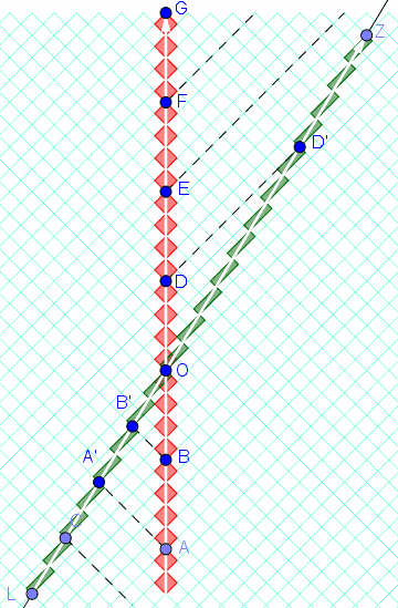

Here's a spacetime diagram [time running upwards] that summarizes what is going on with the Doppler Effect.
Each diamond represents equal units of time on a standard [light-]clock carried by that worldline.
The source at rest broadcasts [in all directions] at the speed of light...periodically at 4-tick intervals, at events... A, B, meeting-event O, D, E, F...
You (traveling at (3/5)c) receive the broadcasts at the speed of light... on your worldline at A', B', meeting-event O, D', ...
As you approach, you receive broadcasts more frequently at 2-tick intervals ("blue shifted" light similar to "higher-pitched" for sound)
As you depart after the momentary meeting, you receive broadcasts less frequently at 8-tick intervals ("red shifted" light similar to "lower-pitched" for sound).
