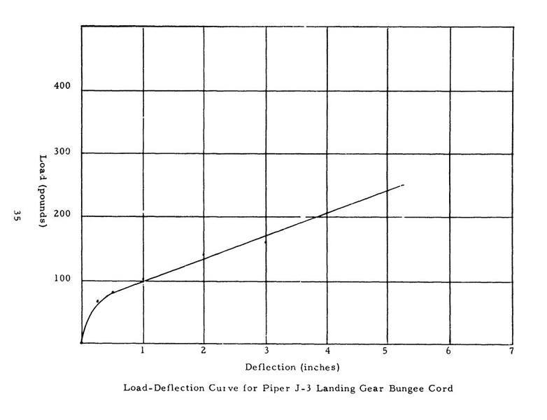

I know this is old data, but I think it may be helpful. I would think that bungees would be a good example of a linear spring assuming there are no weird properties in the lay up or design of the cord. It's easy enough to do this test though. All you need is a fish scale and a pad of paper.
Here is a load-deflection plot for a landing gear bungee cord from a US Army report.

Thank you for the replies. Would it be sufficient to model an equation of the data with a TI-83+'s exponential regression ability? The attachment given by FredGarvin looks like it behaves somewhat linearly at about a deflection of 1in (what is a deflection?), while the site given by Jeff Reid looks more continuously exponential. For the context, I am using this for a projectile launching competition that specifically prohibits use of counterweight and metal springs to provide launching force.

If you look at the data that Jeff posted, it looks very much like the graph I posted. It has a large non-linear portion and then, for all intents it goes close to linear.
