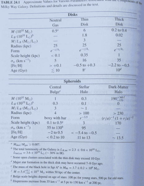

Yes, that makes sense to me. However, below is a snapshot of a table from a textbook I am reading, Carroll&Ostlie. The metallicity is expressed here as iron-to-hydrogen ratio of the observed star compared to the Sun's value [Fe/H]:
[Fe/H] = \log_{10} \left [ \frac{(N_{Fe}/N_H)_{star}}{(N_{Fe}/N_H)_{sun}} \right ]
Halo: from -5.4 to -0.5
Bulge: from -2.0 to +0.5
(Thick disk: from -2.2 to -0.5)
That is what I had in my mind, when mentioned changing and overlapping of metallicities in my previous post. The declared range for Halo stars is quite wide, isn't it? Indeed, I am not sure how accurate or up-to-date are the data in the table, when browsing I found slightly different values from different sources, eg. this one.
But what is also interesting, the authors mention in the textbook, that correlation between age and [Fe/H] may not be 100% reliable. They suggest that some astronomers rather use [O/H] or [O/Fe] ratios. Probably it is not easy to define stellar populations with such a variety of parameters :)
If you talk about Population II stars, do you mean stars with [Fe/H] very close to -5?

The declared range [of metallicities] for Halo stars is quite wide, isn't it? That is what I had in mind, when mentioning changing and overlapping of metallicities...
Yes that's basically because they're all from the same population. Unlike terrestrial physics, because we're limited by our observations and can't tailor our experiments to what we're trying to determine, some areas of astronomy are unfortunately imprecise. Measured iron abundances vary widely from globular cluster to globular cluster, and even within the same cluster. These variations are not errors of measurement, they're what's found in nature. They show that all these structures are all of the same population, and they're only differentiated by their kinematics. It also shows that the thick disk was formed concurrently and not formed by larger abundance disk stars kicked up out of the galactic plane.
The authors mention...that correlation between age and [Fe/H] may not be 100% reliable. They suggest that [we] rather use [O/H] or [O/Fe] ratios.
Yes this was some time ago and they made a good suggestion. Iron alone is just produced in supernovae, while oxygen is formed (along with carbon and nitrogen) in lower mass stars that die as planetary nebulae and white dwarfs. Using all three abundance markers together then gives a more accurate picture of abundance evolution. Ages are still mostly determined by finding a population's turn off point on the main sequence, but this can still vary by as much as a billion years!
