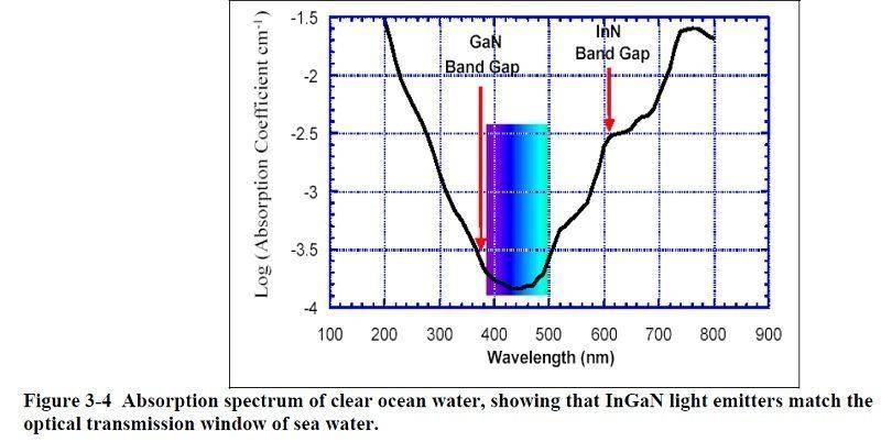

There will be an optical band, probably a blue colour that gets through seawater best. That would be a good use for blue LEDs. Scattering by particles in the water would give good all round communication “vision”.
Excellent idea. I did a search and here's a theses that covers this. repository.lib.ncsu.edu/ir/bitstream/1840.16/570/1/etd.pdf
I took the liberty of uploading one of his graphs that shows the absorption spectrum of clear sea water. Blue it is.

The more I think about it, the more attractive blue light becomes for undersea wireless communications. I see no reason why we could not have several hundred metres of optical internet VoIP in seawater.
