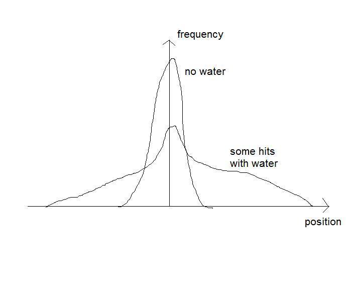

That is an interesting approach.
Here is a simpler version of the experiment:
Create a thin stream of water, which fractures into individual drops quickly. Shoot through the point where you have a high drop density. Check that you can produce this in a reliable way (camera?) and switch it on/off.
Shoot n times without water, ~2n times with water, repeat.
For each set of shots, record the 2-dimensional positions of the impacts. Choose n to have very similar conditions for both shot types, but probably large enough such that you don't have to run to the target after every shot.
Post the raw data here.
The shots with water should have two components: One with the same distribution as the shots without water (no drop hit) and one component which is broader than the other (by some unknown amount) as it has the additional water deflection. I don't know how expensive those bullets are, so it might be impossible to see this splitting, but at least you can check the average deviation and something like the amount of outliers.
I'm not quite sure what you are saying here. I'll take a stab at addressing it.
See attachment. Paint, yeah :D.
I don't know if you're messing with me or what. I have no idea what that means.
He's not messing with you. His laugh was at himself.
"Paint" is the poor mans doodle tool for PC's.
Many turn their noses up at it.
I use the mac version.
His doodle is a graphical representation of the target area experiment I described.
The more water the bullet comes in contact, uni-laterally, the larger the deflection.

Yes I get the "paint" reference; I just didn't understand the drawing.
Ok, I understand what he means now... but trying to hit a single drop is what I need to try for. Because even in a heavy rain, the odds of hitting a single drop is great.
So are you implying that I need to hit more water than one drop? A single drop hit, two at the most is what I need to attempt for the experiment to be consistent with moderate to heavy rain shooting conditions.
I'm confident I'll hit the drops I need to.

@Win_94: A single drop hit is fine, and I don't see where multiple hits were mentioned here. What my graph is describing: Not all tests "with water" will hit a drop, so you have some shots without a hit (giving a narrow cluster of impacts at the target) and some with (giving a broader distribution).
I am not really convinced that the camera can accurately see the hits, so it is good if the study can give results even without that information.
