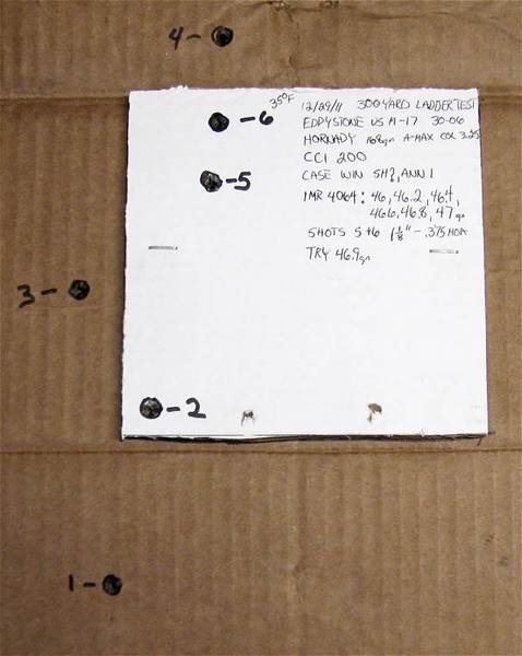

I have some of my so called "evidence" that may be of interest?
I reload ammo, and when I load develop, I use the Audette Ladder Test. It is to find where barrel vibrations are least at the muzzle as well as finding when powder charge weights reach plateaus of velocity.
Since every consecutive cartridge gets a bit more powder, it hits higher than the previous one. Here is an example of one of my latest tests.
There was a major vibration at the muzzle on shot #4 and the barrel whip happened to throw it higher than the next two. All other shots are true to the notion that the faster bullets impact higher; due to reaching the target sooner, therefore dropping less.
Every Audette Ladder Test I have done, with snub-nose 357magnums to 26 inch barreled 30-06 rifles, at ranges from 35 yards to 400 yards, all faster bullets hit higher than slower ones.
I would also add I've noticed a exception to the rule with bullets shot at just under the speed of sound hitting higher than ones shot at just above the speed of sound. A inch or so difference that I attribute to the "bullet bow shock-wave" that supersonic bullets experience.

No. When using a rifle during the ladder test, I rest the forearm on a sandbag and the butt end of the stock on a bean bag. The butt is against my shoulder as normally done, my hand is on the trigger as normally done, but my other hand is squeezing the beanbag as to level the rifle to acquire the proper point of aim.
You can see how it is set-up in this video.

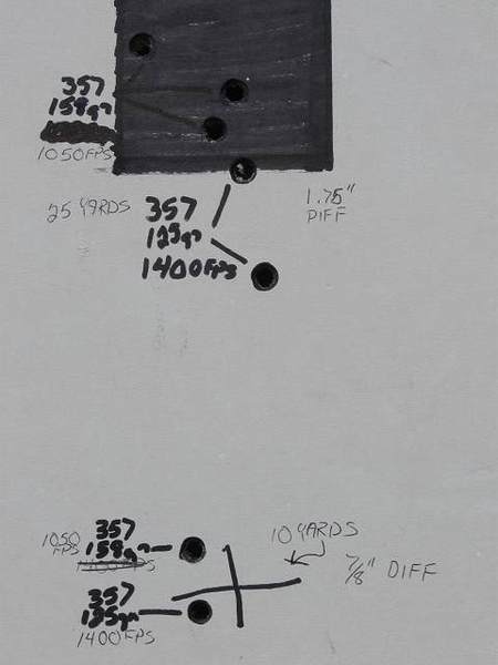

What about the better aerodynamic properties of the heavier bullets?
I knew my scatterbrained posts would make this confusing. I'm starting over, forget everything above this line.
People have claimed that:
Slow bullets remain in the bore longer than fast bullets.
Therefore; with slower bullets recoil has climbed more while the bullet in still in the bore, resulting in a higher point of impact.​
My contention is:
Less muzzle velocity results in the projectile dropping much more than the miniscule amount of barrel rise that may take place. Slower bullets hit lower.​
I goggled the argument; I don't know these people.
http://rugerforum.net/ruger-single-action/45793-heavy-bullets-hit-high.html
http://glocktalk.com/forums/archive/index.php/t-1364952.html
The common theme is velocity.
I would like to stress that slower bullets shot at 1050fps, (subsonic,) will hit higher that those shot at 1250fps, (supersonic.) Many of the handgun people are seeing that effect.
Therefore, we must deal with both bullets traveling at either subsonic, or supersonic speeds.​

Take this an example from the post I linked to earlier.
I bought a box of 240gr Winchester bullets and at 25 yards they hit 6-7 inches higher than the 180's I set the sights in with last week!
Is there some way that you could discount or confirm that amount recoil difference at that range? That gun weighs 48oz. with a 7.5 inch barrel.
I'm thinking, at the most it would climb 1/2 an inch at 25 yards; and they would not notice it because they probably shoot 3 or 4 inch groups.
And at that rate, the "critical range" would be about 300 yards.
Here is my target using my 357, I didn't have enough bullets to load enough cartridgess to be thorough.
But I think that my experiment was flawed since my faster bullets were traveling supersonic and my slow bullets were subsonic. There is a big difference in velocity reduction between the two velocity ranges due to the shock-wave generated by the supersonic bullet.

I think most people that see these great height differences are experiencing barrel harmonics; especially the ones not hand-loading in an effort to eliminate the harmonic effect. I would just like to point to reasoning as to why the POI difference is not that great due to recoil.​
I thank you for all your time and effort! You've gone above and beyond what I expected! Thank you!

A rifle at 100 yards; POI Difference Again.
A pistol at 25 yards; POI Difference 38 Specials
