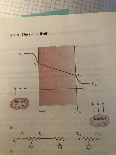

All three modes of heat transfer are happening in your example, radiation likely is negligible.
The heat transfer problem is characterized by convection from the water to the pipe wall, conduction across the pipe wall, and convection to the environment.
This illustrates the problem through a plane wall, but the concept is the same for a cylindrical wall.
Surely we have to be in the neighborhood of what you are after?
Maybe you're asking if because the fluid is static (no bulk velocity) it's no longer convection. That I don't know.
There is a statement in the text book I pulled that from:
"Convection includes energy transfer by both bulk fluid motion (advection) and the random motion of fluid molecules (conduction or diffusion)."

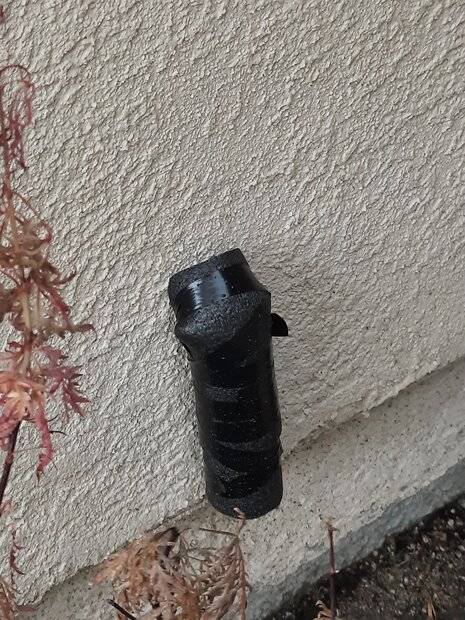

My interest here is finding out something about the inside surface coefficient (h1 in the figure provided by @erobz ) -- in my work life we routinely solved these problems where the inside fluid was flowing, ie, forced convection (we used empirical correlations eg, Dittus-Boelter). In the OP problem, the inside fluid is static and eventually solid (freezing ice). I'm curious if there is a developed correlation applicable to that scenario.
The reason for my interest: in recent cold weather the condensate drain on my (newly installed) tankless water heater froze. This caused the condensate to backup and leak into my garage. After I got it thawed and flowing I added insulation to the outside end of the drain line:
EDIT: following @Chestermiller 's post, maybe analyzing this as a pipe is not the way to go; as he said it's more like a fin. A fin of composite materials, with the outside coefficient based in convection & radiation (thanks @hutchphd) heat transfer, and the inner guts of the fin based on conduction.
