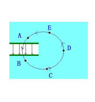

cometzir
The red dot represents a positively charged particle, the blue box represents a metal box, and the two dark green lines represent a capacitor, which has been charged. Each plate of the capacitor has a slit which will let the particle get through without touching the plates. And the capacitor doesn’t contact with the metal box either.
When the particle moves from A to B, it will be accelerated by the electric field. And its kinetic energy will increase.
When the particle is in the metal box, the electric field has no effects on the particle because of electrostatic shielding. So it consumes no energy to move the particle from B to A via C, D, and E.
Then, the particle will move from A to B through the electric field again, and its kinetic energy will increase again.
But in the whole process, it doesn’t need to produce work to keep the electric field, or to keep something else. So the energy except the kinetic energy of the particle doesn’t change. So the sum of energy increases.
Is there anything wrong?

Here is the picture
The picture was helpful. If you add up the electric potential around the loop, the net electrical potential is unfortunately zero, for those looking for free energy.
There is a very sudden change in potential from outside the plates to between the plates. This sudden change in potential undoes the gain in kinetic energy that you get from accelerating between the plate. It is like rolling down a hill into slightly inclined wall of the same height.
Hi cometzir. You understand that a metal box shields from electric fields becasue it is an equipotential surface (which is just another way of saying that all points in the metal are at the same voltage).
Now by definition the two plates on the charged capacitor must be at different potentials (from each other) therefore there must be an electric field between at least one of the capacitor plates and the box, and this is what creates the retarding electric field that DaleSpam refers to.
Hope that helps. :)
So, there is another opposite electric field.But where is it? Is it in the metal box, or in the plate inside? If it is in the metal box, the electric field strength inside the box will not be zero. Is it possible?
The opposing electric field is between the capacitor plates and the metal box. This is very straight forward.

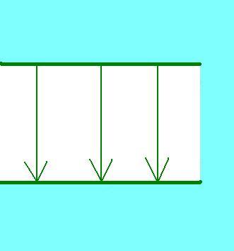

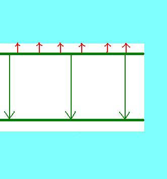

If the capacitor is out of the box, the opposing electric field can be like the red line in graph 1, but if the capacitor is on the border of the box like graph 2, or even in the box like graph 3, can you draw the opposing eletric field line?
Figure 1. Yes that's how it is, neither of the other options shown can work the way you want them to.
Figure 2. If the plates are in contact with the box then all you have is a short circuit and hence no E field. Reason : Box is a conductor, plates of capacitor are conductors, and they're touching. Doh, that should have been pretty obvious to you!
Remember that if you place any insulation layer at all between the box and the plates then you just end up with the first case (figure 1) above.
3. If the capacitor is inside the box (as per 3rd picture) then it will shield the E field from exiting the box and there will definitely still be a field inside the box.
Also, one thing that you should keep in mind is that the approximation of the E-field in a capacitor as being entirely between the plates and uniform is just that, an approximation. In particular, it fails near the edges and on the outside the capacitor field looks similar to a dipole.

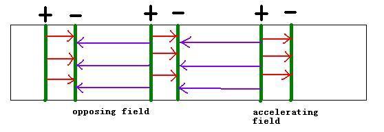

Another thing, think about the Linear Accelerator, it has many pair of plates. Are there any opposing E fields between the plates as the picture shows?
And why is there no E field in the metal box of the cyclotron?
cometzir said:
Thank you.
Re the linac, yes there is opposing E field as shown in your diagram, and this is exactly why it wouldn't work properly if it was supplied with DC voltage. A linear accelerator uses very high frequency AC voltage to supply the plates so that the E field continually changes direction as the particles travel along the various regions of the tube. In other words, what would have been an opposing E field has actually reversed (due to the ac supply) by the time the accelerated particles arrive there.
Re the cyclotron. Are you referring to the "D" electrodes and the fact that there is a strong E field in the gap between the two "D" halves but no electric field within the D's themselves? Again that's only an approximation, some of the E field definitely will fringe into those slotted D's.
Thank you, I think I have understand it.
But how could the Linear Accelerator control the change of the E field? Does it take the same time for the particle travel from one plate to another?
That's why they have electrodes of increasing length along the tube as the speed increases. If the particles reach near c speeds then increasing energy doesn't change the speed very much and the electrodes may then be of similar length.
