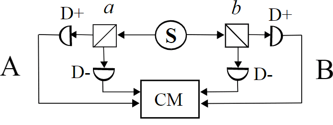

Wikipedia shows the following figure:

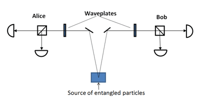

The figure in the book is the following:
In the book, the picture shows the waveplates in front of each PBS, and it says “these plates are set at angles 0, Pi/8, Pi/4 and 3Pi/8”. Wikipedia says “Four separate subexperiments are conducted, corresponding to the four terms E(a, b) in the test statistic S (2, above). The settings a, a′, b and b′ are generally in practice chosen to be 0, 45°, 22.5° and 67.5° respectively — the "Bell test angles" — these being the ones for which the quantum mechanical formula gives the greatest violation of the inequality”.
Thus, Wikipedia does not explain what are these angles 0, 45 °, etc., but the book says that these are the angles at which the waveplates are installed (and Wikipedia does not mention waveplates). So my question is, whether the waveplates are used in this experiment, and what do the angles at which they are installed mean?

Actually, the two pictures in the original post are really the same. Different scientists simplified something pretty complicated in a different way. The Wikipedia drawing has merged the waveplates and the polarizing beam splitter. The idea is that by rotating the plate you rotate the polarization of the photon. Then you let it enter the polarizing beam splitter. That's a bit easier than rotating a polarizing beam splitter. The Wikipedia diagram also merges the source and the two mirrors of the picture in the book. Put it all into one box, so to speak. The Wikipedia diagram on the other hand gives a lot more detail about what happens after the photons have made the detectors click. It corresponds to very old experiments in which you had no control at all over the emission of photon pairs. They were created in a continuous stream and moreover a lot of single photons were also created and moreover, anyway, lots of photons get lost "en route". So in the oldest experiments, you registered the times of clicks at any of those four detectors and if two of them, one on each side, were close enough in time to one another, you treated them as the detections of two photons which had been emitted together.
