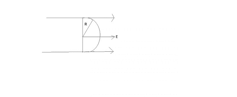

The flux through the hemispherical surface in the figure shown below is
But the above formula is for closed surface .But hemisphere is not a closed surface to make it closed surface we will need another hemisphere .
then the flux through the hemispherical surface should be =Q/2ε0
but this is wrong it should be πR^2E
The flux = π*R2 * E.
Think about what π*R2 actually is.

The answer must be expressed in terms of the facts given. Your diagram indicates a (uniform?) field and a radius. It does not show a charge.
To answer the question in terms of E, imagine closing the hemisphere with a flat disc radius R. What is the flux of E through the disk? Do any flux lines pass through the hemispherical shell but not through the disk, or vice versa?

"which is not the answer" is not correct: Haru asks for the flux through the disk and that is ##-4\pi r^2\,E\ ##.
  1. [edit] sorry, overlooked the 4. flux through the disk and that is ##\ -\pi r^2\,E\ ##.
You did very well letting the area vector for the disk point to the left (the outside of the hemisphere).
Now your relevant equation comes in very handy: Let S be the hemisphere. There is no charge inside, so ##\oint \vec E \cdot d\vec S = 0##. For the disk part you have a value and the bowl has to have the equal and opposite value to get that zero.

The flux through the disk = πR2*E.
The E-field is perpendicular to the disk ( not to the all over hemisphere ).
When you close a volume by the disk+hemisphere, that does not include any charge, the sum of the fluxes: ψdisk + ψhemis = 0 →
ψhemis = -ψdisk

Ψ = Area*Ψdens*sin φ = πR2*E*1.
How does 4πR2 get into it ?

You have a uniform field E at right angles to a plane surface (disk) of area ##\pi R^2##. What flux does that give?

-EπR2

There is no dichotomy here. The two methods are completely consistent.
Say you have a cube with a charge somewhere inside it. You can use Gauss' law to find the total flux very easily; but if you were to figure out exactly what the field looks like, integrate the field over each of the six square surfaces to find the flux through them then add these up, you would get the same answer. Just use the method that suits the question.
In the present case, you are given a uniform field E passing through a hemispherical shell parallel to its axis. You do not know what is generating that field, or where it is - it doesn't matter as far as the flux through the hemispherical surface is concerned. By presuming that the field remains continuous over the whole interior of the hemisphere, and adding a disk surface to enclose the region, we can do two things:
- easily compute the flux entering the half sphere region through the disk;
- use Gauss' law to deduce that an equal flux passes out through the hemispherical surface of the region.
