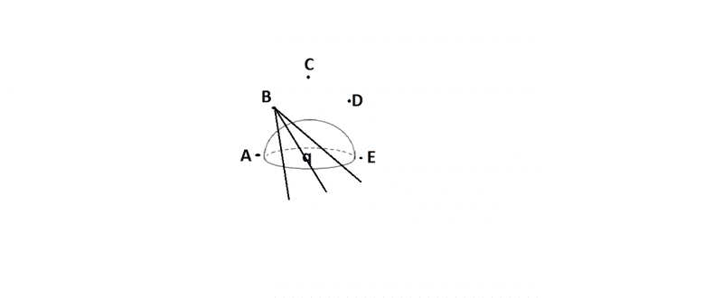

When I draw for point B ,The line emerging from it also cuts the surface twice

It is not possible to deduce from that drawing whether it cuts once or twice.
I interpret the diagram as meaning that the five points lie in a vertical plane bisecting the hemisphere. Consider looking at the hemisphere from point B. Some lines from there might cut the hemisphere twice, but if there are any lines that cut it only once then there will be net flux.

Imagine the hemisphere as made of tinted glass. If you were to look from point B, what would it look like? Are there parts where you would only be looking through one glass surface?

Picture the hemispherical shell as half an empty egg shell. All you have to do is to count whether each particular field line encounters hard shell once, ... or twice.
Draw lots of lines from B radiating in all directions. Where a line is "inside" the hemisphere, that portion of the line will be hidden behind the shell, so don't draw that obscured portion of any line.

Although I have not drawn lots of lines but I think I have found the one needed.
  • #41
I think you are saying you have drawn a line that does contribute to the total flux. Can you draw on the same figure a line through the curved surface but which does not contribute net flux.

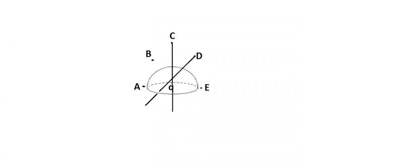

Electric field lines contributing to the electric flux originating from Charge kept at points C &D.
Right?
I think there can not be any line ORIGINATING from B ,C & D that cut the surface twice or more.Right?

Wrong. Get half an orange, and a steel skewer, and I'm sure you'll find many ways to pierce the orange so that the curved surface gets holed twice. One hole on entry, a second at its exit.

Yes they will. Consider B. A line straight down will only cut the surface once. A line making a tangent to the hemisphere will not cut it at all. A line ever so slightly below the tangent will cut the hemisphere, taking it to the inside, but almost immediately cut it a second time and find itself back outside.
However, this is irrelevant to the question. To answer the question for B you only have to find one line that only cuts the surface once. Whether there are also lines that cut it twice is a separate matter.

Because the direction in which the line passes through matters. Consider a closed manifold. Having passed from outside it to inside it, a second crossing by the flux line must be from inside to outside. That has the opposite sign and the two cancel.
