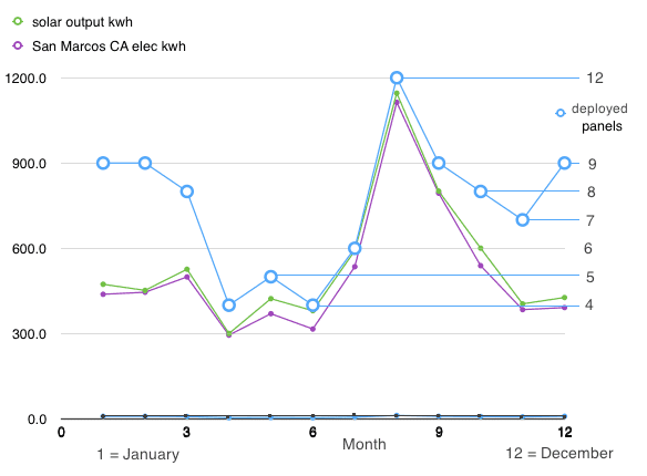

I'm designing the system for my sister, who is Zoobs neighbor. And based on his landlords comment about it not being worth it to sell back extra energy, I've designed the system to only create as much energy as is required.
Since the system requires a minimum of 4, and a maximum of 12 panels, the system will consist of 4 stacks, with unused panels being stored beneath the top panels. This could extend the life of the 3 panels only used in August to between 100 and 200 years. I've been getting fuzzy statements regarding why solar panels degrade. Which is somewhat understandable, as it's still a relatively new, and continuously evolving technology. Of course, if and when San Diego residential installations can sell their energy on the market, it may make financial sense to deploy extra panels.
Here is a graph of my sisters electrical usage over the last year, required number of panels, and their output.
System output is based on cloud cover, length of days, and number of panels. Sunlight hours varying from a minimum of 158 hours in December, and a maximum of 329 hours in July.
The spike in August is due to A/C. Which is ok with me. I installed my first one in my house about 3 years ago.
