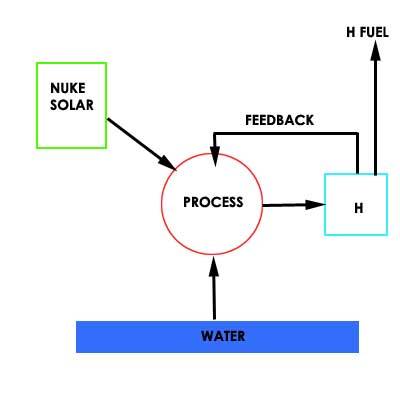

cant we kick start H harvesting with nuke plant, and then via feedback process you use some H to get some H and the differential is supplied by the nuke plant (to get the additional H that the 1st subset of H used to get H).
like this, nuke at night, solar during the day. no batts needed :wink:, but can this scale at 53.6 Ampere-Hours per 2241 litres (2g of H), and 1kg of H = ~1gal of gasoline = ~30mi.
"Feedback process" is just a term for fantasizing about perpetual motion. Feeding the hydrogen back into the hydrogen production process provides a net loss, not a net gain.
Otherwise, the idea of hydrogen as energy storage is ok, but I don't think it will become widespread for a good 50 years or so. It is too inefficient and doesn't solve the most important problems (getting rid of coal and oil).
if the process is more efficient at running on H than it is from nuke or solar (well, solar is free), you can get most efficiency by using some feedback of H. you did notice i did mention the solar & nuke would need to supply the diff, yes? i did not say H feedback alone runs the process after start-up. so the problem is less about the source and more about the efficiency of it all. even solar has problems, namely footprint, so in solar terms and for just about everything these days, power density is the key term. lithium batts have a larger power density than lead acid and lithium batts cycle better, but at what cost? the cost of improper disposal, the costs to harvest lithium, which is limited btw. can't we use solar to pump a ton of sea water into the great lakes during the day, and then at night catch the water in hrydro plants as it travels back to the sea, no harsh pollution in this process, a pseudo capacitor. just because Musk built a big chemical plant doesn't mean that's the solution, because its not. "Buy lithium batts" is like "Buy DC power" that Edison once sold. you can think of lithium batts like facebook :frown:

Physics_Kid said:
what are these hydrogen fuel cells i hear of?
They use hydrogen produced somewhere, either from natural gas (then you effectively burn that) or via electrolysis (then you have to put in more electricity than you get out).
A "feedback" system does not make sense. You can produce hydrogen from electricity, you can store it, you can burn it (in fuel cells, ideally) to recover a part of the invested energy, typically about 50%. Done.
